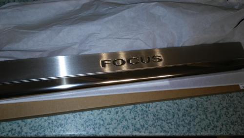

The next cosmetic piece has landed.
very nice
Wanted to order some of these until I realised they don't come for all 4 doors
looking good
  • 3 weeks later...
Scuff plates on and a nice polish in sun.
Nice job, sill plates are a really nice touch, adds a bit of class when you open the door I think.
liking the sill plates and great job of the clean up
