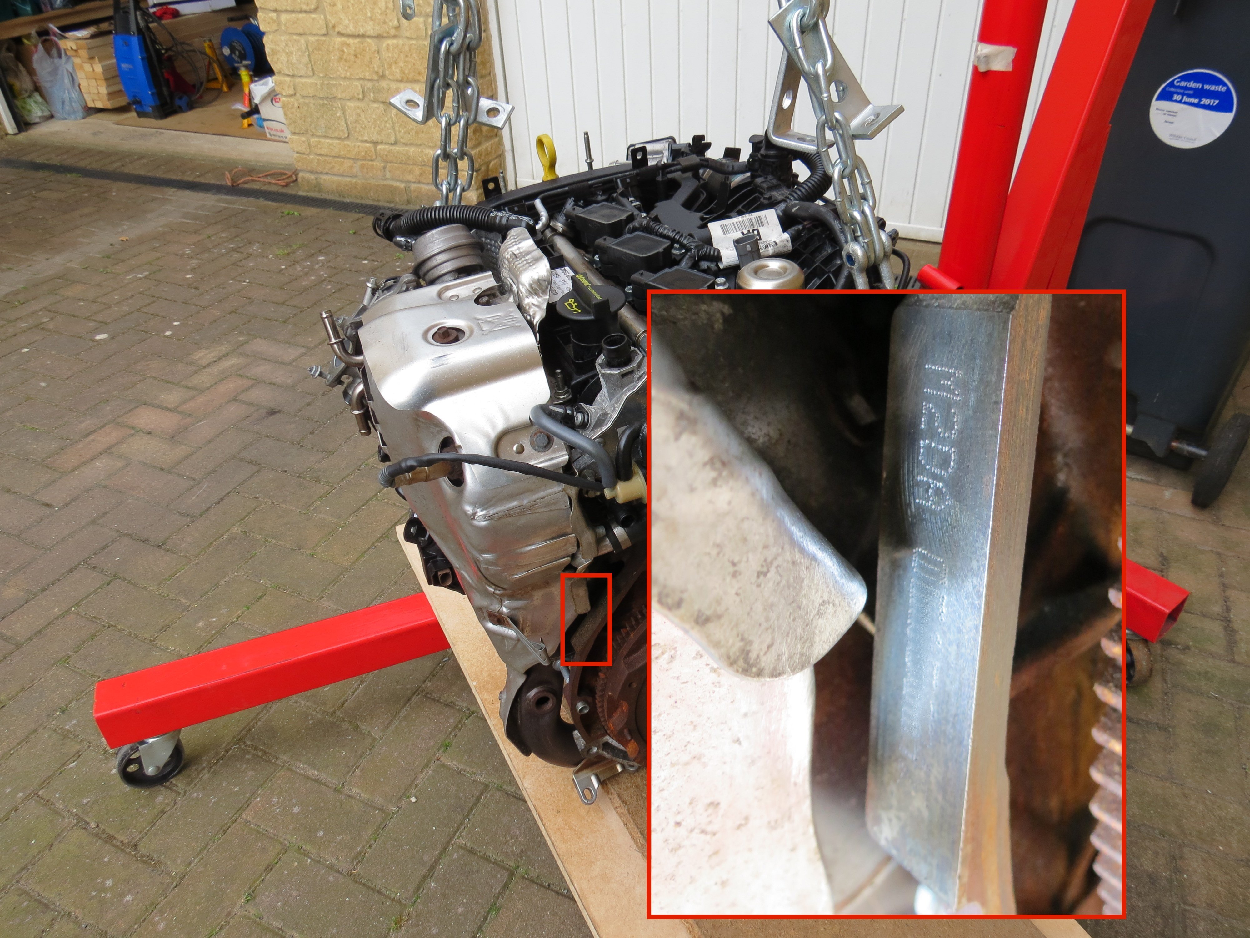

the sticker on the front should say what engine code it is
It's code is M2DA (from a Focus I believe). Speaking of codes, bringing the thread full circle here's a photo of its location for the sake of the archives:
Looking at mine again I can see now that it's SFJA. The surface rust had made it look like the plate was smooth but with some wire wool and a torch shone at an angle I could just about make it out!
