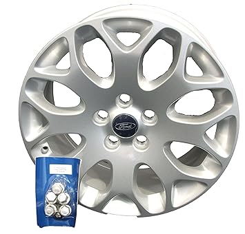

@jw1982 said on another thread " be aware that Ford has changed the wheel nut design. in 2012 Ford introduced the new Global Wheels and Global Wheel nuts to reduce the different types of wheels and wheel nuts on all Ford models. Global Wheel nuts are not compatible with the old design alloy wheel. When buying wheel nuts you absolutely have to buy the correct type of wheel nuts for the wheels you have. Installing incorrect wheel nuts can result in loosing a wheel."
jw1982 definatly knows his stuff,
Like Ian said it is very important to use the correct wheel nuts.
About 2012 Ford introduced the new design Global wheel nuts and Global wheels. The reason for this was to reduce the large amount of different wheel nuts which were used.
Mixing wheels/wheelnut design should be avoided at all times.
Note that new original wheels from Ford should come with the correct mounting kit. This kit includes the correct wheel nuts and valve stem. In the past I bought several new wheels from Ford and they always came with the mounting kit.
Afbeeldingsresultaat voor ford 8 spoke Y design nuts
Some sellers however do sell the original wheels without the mounting kit. They simply take the mounting kit out of the box. This way they can reduce the price of the wheel a bit and make a profit out of the mounting kits.
