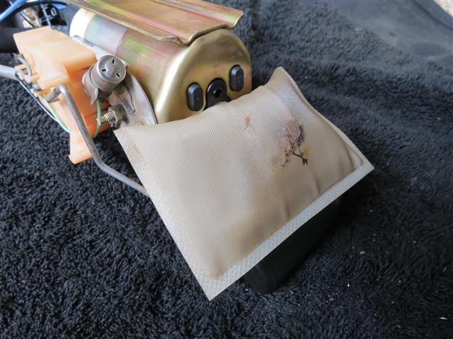

Most fuel pumps draw fuel from the bottom of the tank constantly so I don't think it makes much difference these days. Also, fuel is far cleaner then it used to be.
My biggest concern with running out of fuel would be the sudden and complete loss of power.
i was going ask where does everyone think the fuel is drawn from? right at the bottom within a few mm in a recess normally. lol
and most debris in tanks used to be from rusty tanks years gone by before plastic tanks. ive had lots of plastic tanks dropped down inspecting pumps/senders and nearly all the occasions the tanks were spotlessly clean.
on my mazda6 i could go another 60 miles when it showed empty
I broke my Hyundai Coupe for parts having done 160k miles in it over 13 years. When I removed the pump both the tank and in-tank filter (shown below) were as you say pretty much spotless.
I must admit; I was actually quite surprised myself!
(Incidentally pretty much every fill-up I did in that car was from a near-empty tank as I religiously monitored its fuel consumption and so wanted to minimise calculation errors)
