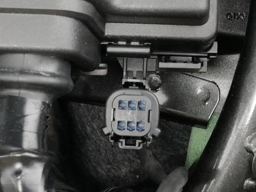

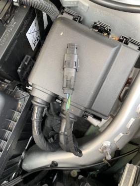

What is this loose cable?
Can any of you experts tell me what the loose cable is on my new mk IV focus?
near the battery, doesn’t appear to go anywhere?

Any ideas? Can someone look under the bonnet of their focus and see if this cable is there?
it would be appreciated save a long drive to my dealer
@iantt  may know 🙂

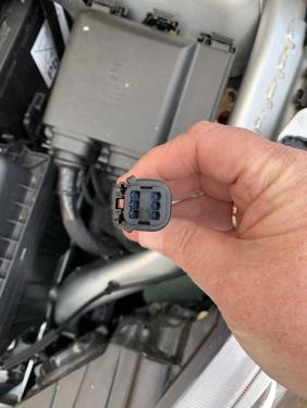

The connector is blanked off with a blinding cap (contra connector with only rubbers seals to prevent water/dirt Ingress). This suggests that the connector is used for functionalities/options that the car does not have. If it was just a loose connector there would be no blinding cap installed.
The only thing that seems strange is that the connector with blinding cap is not secured to anything. Ford usually secures unused connectors to the wiring harness using (wiring harness) tape or to other components using plastic connector clips. However the connector with blinding cap not being secured to anything can also be another example of reducing costs.

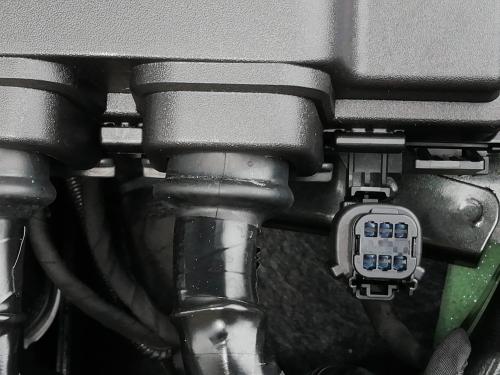

Yes, mine has the same unused connector, the only difference is that mine isn't dangling loose. It's clipped to a tag on the fusebox. It's just to the right of the 2 cables in the photo. Connector is facing upwards. Photos attached
To reassure the OP.
Yes, I just looked under the bonnet of my car and I can confirm that I have the same unused connector, exactly as shown in Ian's photos.
THANKS ALL FOR YOUR ASSISTANCE.
mine is back on its clip.
