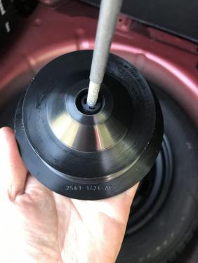

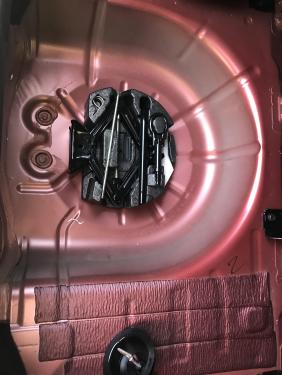

LondonFiesta Posted May 4, 2019 Author Share Posted May 4, 2019 Here’s what I have in pictures. Same kit as the one recommended for the 2012-17 cars but I have a 15” wheel The kit here, shows I have what I need - is this it? Am I right I thinking nothing else required and the foam was a wild goose chase? https://www.fordpartsuk.com/ford-fiesta-14-spare-wheel-kit-from-05-11-2012-to-15-05-2017 Thanks The tool kit and piece of carpet The wheel and the retainer/cup Quote Link to comment Share on other sites More sharing options...
robbyvrs Posted May 4, 2019 Share Posted May 4, 2019 Ah - you've got a skinny space saver, this could be why your carpet sinks as the tyre isn't as wide as 1 fitted to a 14" spare wheel 1 Quote Link to comment Share on other sites More sharing options...

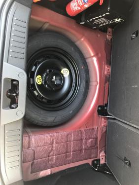

tarbyonline Posted May 14, 2019 Share Posted May 14, 2019 Here you are, as supplied by the dealer on my ‘17 Zetec nav. No spacer and no need (or space) for one as the “cup” sits in the centre of the wheel. The tyre walls come up basically flush to the level of the boot floor. 1 Quote Link to comment Share on other sites More sharing options...
LondonFiesta Posted May 14, 2019 Author Share Posted May 14, 2019 Here you are, as supplied by the dealer on my ‘17 Zetec nav. No spacer and no need (or space) for one as the “cup” sits in the centre of the wheel. The tyre walls come up basically flush to the level of the boot floor. Thank you so much. That’s really helped! 1 Quote Link to comment Share on other sites More sharing options...

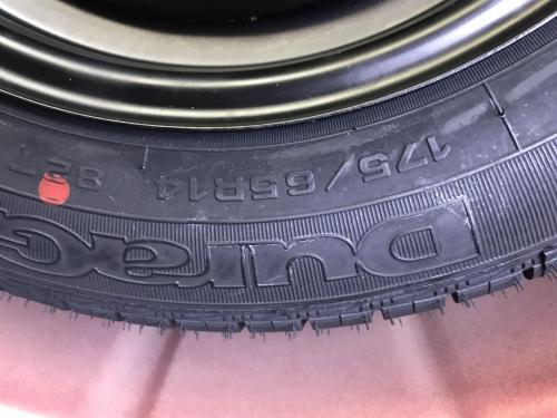

tarbyonline Posted May 14, 2019 Share Posted May 14, 2019 5 hours ago, LondonFiesta said: Thank you so much. That’s really helped! No worries. The dealer supplied kit appears to have all the bits you need, except for the tyre. It's a 175/65 14. Any tyre place should be able to supply one of those as its a standard size, unlike the space savers. 1 Quote Link to comment Share on other sites More sharing options...
