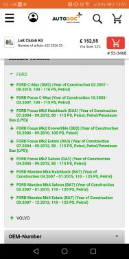

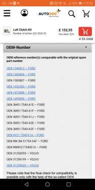

Can anyone confirm for me that the LUK CLUTCH KIT 622322633 will 100% fit my 2009 1.6 focus. Its the petrol zetec model (100bhp not the 1.6 Ti-VCT Engine).
I think it does but just need a second option before I make a purchase. Also do any new bolts come in these kits or do we just the old ones?
According to the same on autodoc..
Thanks Ian, I never though of checking it with auto doc but it seems to suitable.
Thanks Again.
No probs there is some work involved doesn't seem to hard but alot of dismantling.
