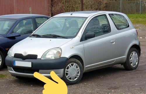

My mate has a 2000 registered 1.0 Litre 79BHP Toyota yaris nick named the "chicken chaser" to use for commuting 20 miles to work each day,
iMarkup_20190707_200345.jpg.d714dfdbf3fc84b2398feffc39c88323.thumb.jpg.9fcd658a059ed92b1266c79a6014228b.jpg
I've gotten a lift to work in it a few times and hes complained about it needing a sixth gear as its revved out in 5th 😄 and also the quality of the headlights aren't fantastic.
The headlights dont have a projector lens there just a large single lens,
So;
Has anyone got advice on fitting some H4 LED without blinding other road users?
Or is it best just to fit some osram night breaker bulbs?
I was thinking either those osram bulbs you mentioned or even the Philips Xtreme vision bulbs or even their white vision bulbs which are I heard close to xenon white. Problem with LED is its kind of unpredictable where the light will shine in a housing designed for a halogen bulb.

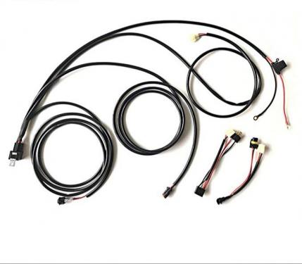

H4 headlight loom for light bar output

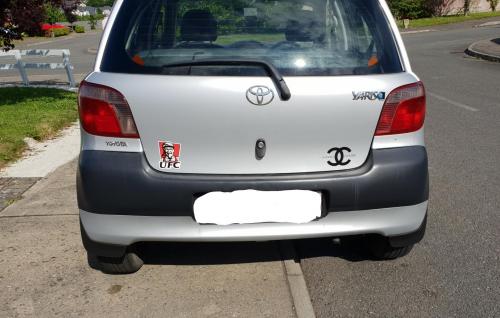

The UFC one arrived today ☺️

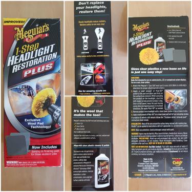

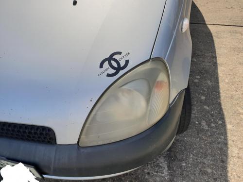

I managed to purchase this Meguiar's headlight restoration kit for €16.60 comes with the polishing pad to fit to the drill,
Will hopefully restore these headlights to almost new condition to get the most from the new bulbs when fitted,

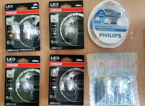

iMarkup_20190707_200345.jpg.d714dfdbf3fc84b2398feffc39c88323.thumb.jpg.fff52d23c1141da6002f5886aac937bf.jpg
The items from Amazon have started to arrive too;
I do like the way Amazon compiles orders in to one box; saves embarrassment at the door when receiving delivery as our local postman must have a huge Mortgage or is extremely passionate about supporting local businesses as he gets quite arrogant when I recieve a few packages; perhaps he thinks I don't work since I do work continental shift patterns six days per week which is actually working more than most.
But anyway; bulbs arrived so far:
20190707_202747.jpg.dd4b18541469bfb1db6ff7e6e8366513.thumb.jpg.a9aff01f66c30b9589cf18a8cd2aa09d.jpg
Still waiting on the T10 chrome side indicator bulbs, replacement reg plate, 12v USB socket, chicken chaser decals, light bar bracket & either one of the two H4 harness piggyback wiring looms,

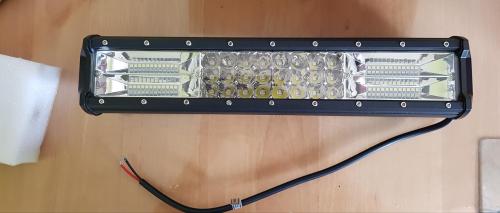

The 216W 15" light bar arrived today from Amazon and its very impressive but it's a bit small 😬 well it is 15"
I don't like that I've found myself becoming too tied to the internet and the sofa when it came to ordering this LED light bar which has ended up costing me 9.00 GBP if I wanted to return it 😂
This is embarrassing but I'll post it on here anyway; perhaps some can relate,
When choosing the light bar size; I didn't bother getting off the sofa to measure the width of a standard registration plate 😬

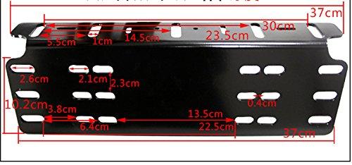

Instead I got lazy and navigated online to the listing for the light bar reg plate bracket 👨‍💻 and looked at its width then assumed it was the exact same full  width as the full width of a standard registration plate,
The bracket width is 37cm as saw in image above; so I assumed the width of a uk reg plate must also be 37cm 🤷‍♂️ which is 14.567inches
Based on those findings; I ordered a 15" LED 216w light bar to fit underneath the registration plate for 35.99GBP
It is very impressive 😯 but it's a bit small, at this point; I still didn't go outside and meassure the width of a reg plate 🤦‍♂️ Instead I fetched the measuring tape and checked the width of the light bar and it is exactly 15" which is what I purchased.
I then finally went outside the front door today and held it next to the rear registration plate of my focus:
where it became apparent that the light bar was somewhat slimmer in width compared to the registration plate,
It turns out the width of a registration plate is 520mm or 20.472 inches
Now although the illumination output from this 15" bar is more than sufficient at 216W and it has a 7D lens to spread light better;
Its going to look a bit small fitted in the centre of the registration plate at the bottom of my mates Toyota yaris
Amazon do accept returns but they want 9.00 GBP from me to ship it back; which in this case is a penalty fine for me not getting up off my A and measuring before purchasing 🤦‍♂️
I've since purchased a wider 25" unit for 46.99GBP which will sit 2.5" wider than the registration  plate and is considerably brighter at 500W LED with the same 7D lens for better spread on the road.

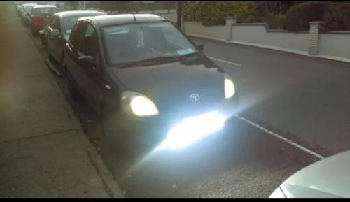

I've been looking at Toyota yaris for sale and breaking on various websites in order to get a good look at the dashboard to see where the 12v USB power socket could be best fitted and I've found a Yaris for sale which has a huge light bar fitted;
It really is styled to a particular characteristic taste this one the slang is even apparent in the listing description aswell as the lack of vacuum usage in the boot compartment and I particularly like the non required image of the dials clearly showing an active oil light 😂 really helps sell it
http://www.adverts.ie/17904845

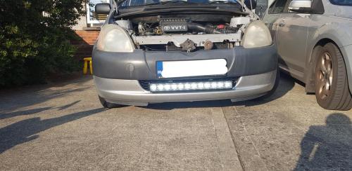

In my opinion 15" is probably quite sufficient but may look a bit small under the registration plate; where a 20" is more shall we say "aesthetically pleasant" in line with the size of the reg;
The 25" is as big as I would fit on the yaris as it will sit neatly inside the lower grill.
But this outward curved 28" here is a bit too much;
Being curved; it also sits outside the lower grill which doesn't look the best atall
where the straight one were fitting using the "L" plate bracket fitted backwards;
will allow the light bar to recess in to the bumper looking more streamlined and will be the same width as the registration plate with three rows of LED where that one has two rows.
For the selling price of €350 it would probably be better off listed as selling a light bar & alloys with free shipping 😂🤣 rather than a car for sale.

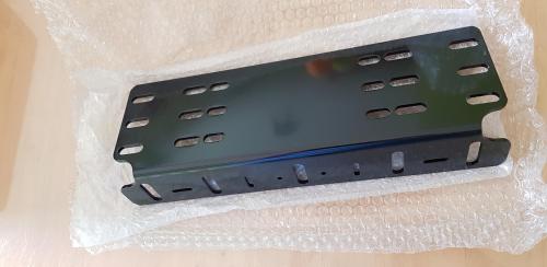

The light bar bracket has arrived along with the replacement reg plate
as you can see it's got plenty of holes fitted making it more adjustable to requirements; I'll be fitting it in reverse form and upside down as shown above with the bracket fitted inwards on the lower grill of the mk1 Toyota yaris.
The registration plate is 20.5" where the new light bar is 25" so it should look good being a little bigger than the reg plate on either side.

How will you restore the headlights? Are you going to remove them or do it on the car? Be careful not to scratch that sticker.
I think hes going to lift open the bonnet and mask the rest of the area,
He said the bumper has to come off in order to remove the headlights,
And in my opinion to be honest there not worth the risk of damaging the parts because the entire vehicle cost him €500 and only used for commuting to work, its almost twenty years old and has more spots of patina on the body than a Ginger kid has freckles 🙊
He just keeps it serviced and certificates in order insurance, tax, and MOT, if a clip or something snapped then it's the bother of chasing breakers yards to find replacement; and would be terrible if the headlight broke when refitting after restoration.
I reckon he will keep the bonnet open then mask up the remaining area,

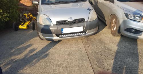

Update on the light bar and where were situated,
I now have everything ready to go since the 25th July when one of the two wiring harness arrived,
I only need one; but as suspected the customs in this country have grown quite attached to one of them currently delayed three weeks now they have it in Dublin Airport since the beginning of July; but thankfully this one came in through Portlaoise via address Pal in the uk.
Means I can now get fitting and sell the other one when it arrives as they cant bd gotten anywhere fast.

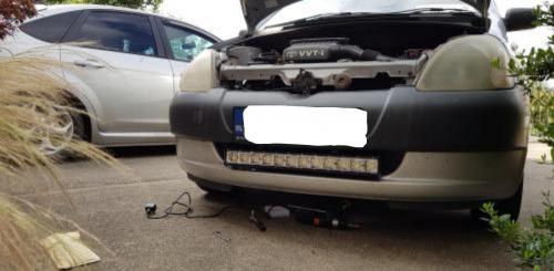

Anyway on with the update:

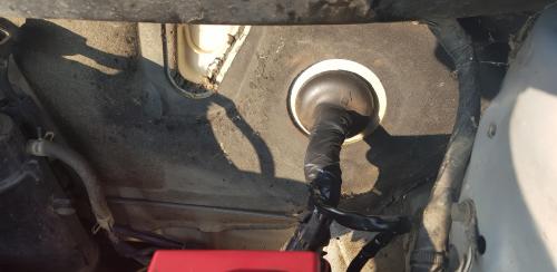

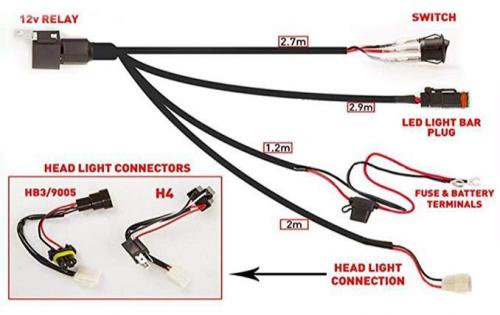

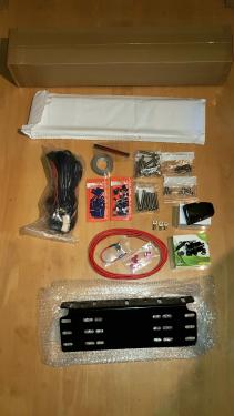

Above you can see the H4 high beam to Light bar wiring harness on the top left along with the 25" LED Light bar, replacement registration plate, a Turbo badge for the boot of the 1.0 naturally aspirated vehicle☺️, spade connectors, some 15Amp cable and a piggy back fuse adapter to fit a 3.0 USB power supply which is also there along with an optional surface mount box only required if drilling the dash is not appropriate.
Some M8 carriage bolts, penny washers and lock nuts to secure the registration plate bracket to the bumper with the large diameter washers increasing the grip inside the panel.

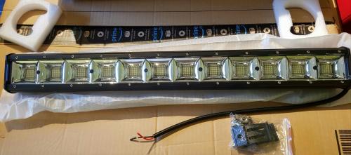

Above you can see the 25" light bar
Personally I think it looks very impressive and alot better than the previous 15" model I initially purchased for fitting as the lenses are consistent across the face of the unit.
iMarkup_20190630_114245.jpg.c20108fb70f914543dfd89edbabcbf31.jpg.bdeb771a21a643582f83f0f7f4a5fbff.jpg.74331f6534a9152a279eeb6abcac7f56.jpg
The registration plate is a little under 20.5" inches so this 25" light bar should look tidy tucked in under the reg plate with around 2.2"inches of bar on either side if fitted 😅

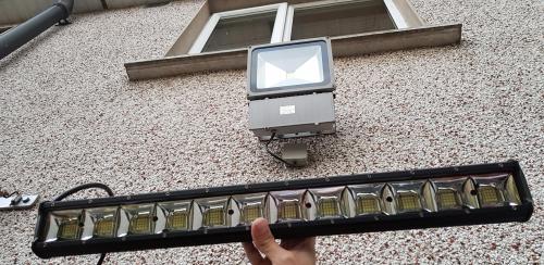

I have a 500W LED floodlight in the back garden which is equivalent to a 1200w Halogen light; heres the 25" light bar held close to it; the one SMD pad in the garden floodlight looks to be much the same size as one of the twelve fitted in the light bar 😂 that's some serious potential from the bar.
Picked up some HSS space drill bits for fitting the 12v rocker switch and USB power socket in the dash;
The H4 high beam to light bar loom has a 12v rocker switch as part of the loom which allows the driver to disable the light bar if required,
I like this feature as if stopped by the police and asked to demonstrate high beam; just turn off the rocker switch prior to switching full beam headlights to disable the light bar from function as there for off road use only.

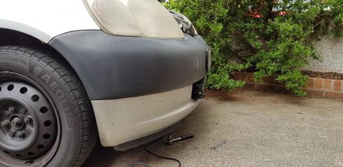

Now all ready to fit since last Thursday 25th July; were both off work since 26th July for a week holidays as the plant is closed for maintenance;
Neither of us are going abroad anywhere and I'm at home since Friday with not really much to do; I told him last Thursday that I've got everything now ready to fit so I'm waiting on the call to arrange installation.
Half the osram bulbs purchased and presented to him at an earlier date; didn't fit the specific vehicle
Seems I recieved the wrong fitment information from websites; thankfully the Philips H4 were correct though and are a massive improvement although the 25" LED light bar with the 7D lens will most likely be the icing on the cake 😯👌

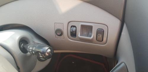

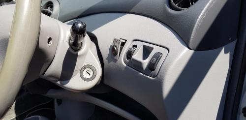

And by 21:45 I have the first job of fitting a 12v USB Power Socket complete.
Looks as good as factory fitted in the lower centre of the dash with three storage pockets situated above.
A 3.0 USB socket with battery voltage display in a nineteen year old car looking factory Fresh 👌
The USB port is wired to a permanent live socket on the fuse board; it has a rocker switch on the face of the unit allowing for it to be switched off when not in use to best prevent battery drain, currently reading 13.0 Volts DC
I've left the supplied rubber cover fitted; let him decide whether to leave it fitted or remove it.

Biggest job with it is; routing a 15AMP cable in to the drivers side of the dash
The cable has to travel through the firewall on the passenger side of the vehicle and across inside the dashboard from a new relay fitted in the engine bay.

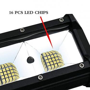

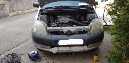

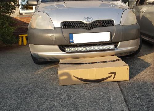

So the following morning after fitting the 12v USB power supply; I began fitting the 25" 7D LED light bar purchased from Amazon https://www.amazon.co.uk/dp/B07QHLBDZ5?psc=1&ref=ppx_pop_dt_b_product_details
I used some PVC tape to hold the polystyrene packaging over the lens to protect it while fitting;

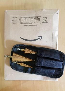

Meassured a few times before drilling two 8mm holes in the bumper and fitted large diameter M8 penny washers to both sides of the holes in the bumper to maximise grip surface and prevent the bolts tearing out in the future.
I ensured the light bar was fitted back far enough inside the bumper to protect from impact in the event the vehicle was to kiss somthing; the light bar wouldn't get cracked as you can see in the image below; the registration plate is the first item of contact on the vehicle.
The 500Watt light bar is fitted on two adjustable brackets which are fitted to the bumper with two M8 bolts, theres a large Mi penny washer on both sides of the bumper hole then a plain 8mm nut followed by an 8mm Lock nut to best prevent them coming loose through vibration.
The factory grill still remains in place; with the light bar loom travelling in through the top of the grill; cable tied along side the factory loom for the horn heading over to the passenger side of the engine bay towards the battery & firewall grommet.
Theres also enough space between the inside of the bumper and the radiator to fit your hand inside; in order to adjust the angle of the light bar by loosening the Allen head bolts on the rear of the two brackets.
With the light bar now securely positioned; I went ahead and removed the packaging which I was using to protect the lens
☺️ I had a cup of tea at this point and admired it from a few different angles 😅 it fits in there so well with equal gaps of grill on both sides and the layout of the lens formation helps keep everything centred & cemetrical and doesn't protrude Beyond the bumper, almost looks rally style.
If it wasn't a 1.0Litre 😂
Made up some light brows using Grey PVC insulation tape 😂 looks mean

I then unpacked the wiring harness which took over three weeks to arrive; I usually try out things like this before fitting or "bench test" as you might like to describe before taking the time to install,
This time I didn't bench test it; I just started fitting, theres the relay fitted on an M8 bolt in image below:
Then took the time to unravel the tape from the nineteen year old wiring loom grommet and routing a further three cables through it from the engine bay in to the passenger footwell;
followed by routing them across to the drivers side of the dashboard where a rocker switch is fitted replacing an old unused toggle switch,
I hadn't written on the dashboard; that's not to my taste atall 😬 done by a previous owner for an old switch; I since removed the writing and fitted the switch wiring,
All cables discreetly routed in now to appear factory which is the way I like to install everything as much as possible

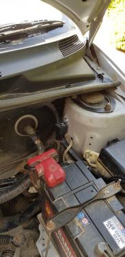

And.... unfortunately after fitting the entire pre-wired loom it's not functioning as it should 😯😫
When earthing the loom to the chassis; the earth was arking in other words it was sparking off the chassis, meaning somehow theres power getting to an earth inside the pre-wired loom,
The next issue was; when the loom was entirely fitted, the parking lights were continuously active which would drain the battery,
The icing on the cake then was; the light bar came on after the full beam went off 😂
I checked all of my connections were 100% then I went to the local motor factor and bought a replacement relay which didnt solve the issue neither.
So I then rewired the loom near the battery in the engine bay; fitted an additional 15AMP fuse and replacement relay; so now the LED light bar operates independently via the rocker switch fitted near the ignition on the dashboard.
It will illuminate via the switch with or without the engine operating and completely independent from the standard high/low beam driving lights which will also keep the law happy.
Above you can see it illuminated during the day,

 Now the Philips H4 have been fitted; he says there brighter than the stock and are an improvement; I've saw them fitted for myself and they are a nice white light however the yellow on the weathered headlight lenses is tinting there output to a shade of yellow ☺️
He has the headlight restoration kit which I gave him; says he will get around to using it soon, although I think the pressure of getting it done might have been eased by the installation of the light bar 😛
I do hope he gets the headlights restored soon though as it would look better along with the chrome shine from the light bar itself,
Unfortunately the chrome indicator bulbs were pointless as the lenses are tinted inside,
