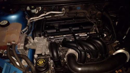

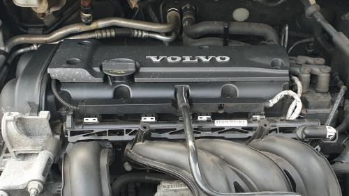

I was searching around regarding the Volvo engine cover cos I'm thinking of getting one and filing down the Volvo logo and maybe painting it to look good. Then I came across a post in here and I'm wondering what is the purpose of the filter in this pic below? I tried searching but nothing 🤪
Crankcase breather afaik, normally the hose runs to the bottom of the air box and ends in a block of sponge material to absorb any oil.
Ok thanks m8 so the filter he has added helps the breathing then? Just first time I have seen one like that.
IMO seems more like a lazy "tuning" solution.
+1!
Messy if the oil escapes on a hot day.. A friend did it and his fell off during a long run.. nice and lubricated under the bonnet and smelled great after! 😁

It's a bad idea tbh, just a temp fix while you get a catch can plumbed in at best.  We did it on a mates car when fitting ITBs so had nowhere to plumb the breather.  The hot oil fumes come in through the cabin vents and make him feel really ill...
Can imagine well at least I won't be doing that.
