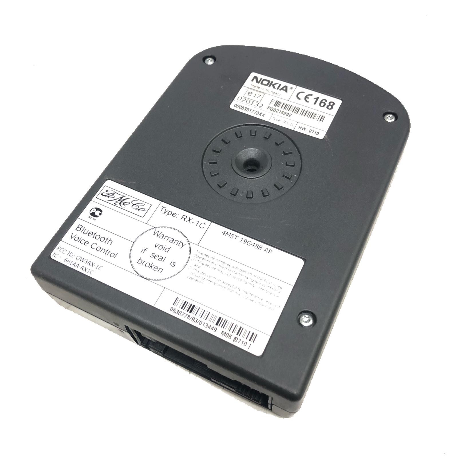

They are seperate from the radio and screwed up behind the glovebox liner.

The glovebox needs to come out (it's only a few screws so it's not a big/tricky job).  By "liner" I think @Stoney871 meant the plastic "liner" of the glovebox rather than the material cover for the fuse box.
**EDIT - The module looks something like this**
Edited by 1979Damian
Added a pic of the module in question

Thanks guys. Again, I assume the wiring loom is standard even if the Bluetooth wasn't fitted? So it's just a case of sourcing the module and probably a suitable mic if it turns out that's not present either? And hopefully these are both "plug n play" too 🙂
As far as I know the loom is standard.
there was a post recently saying wiring loom not std....
not one in my car... there is now for 40 quid, see the last few posts here... people should search
