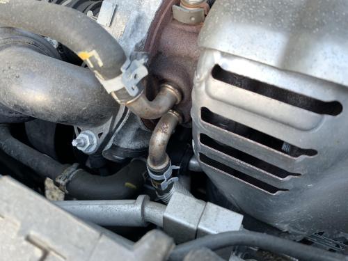

@TomsFocus I remember we talked about a few other pipes and their potential to rust on the ecoboost engines... I’ve attached an image of the current state of mine.
As you can see mine have a little rust... would be a good idea to use WD40 on these to scrape it off? It doesnt look like any corrosion is there, just some rust on the surface of it

Yeah, that's just a bit of surface rust so far, it would be worth rubbing them down with a bit of sandpaper and then painting them to stop any further rust imo.  You won't need any WD40 though, all that'll do it stop any paint adhering properly. :smile:

Thank you, Tom. Will give them a rub with some sandpaper and will let you know how I get on!
@TomsFocus Guessing you mean some anti-rust paint yeah? 🙂

It doesn't need to be anti rust but you can if you want.  Any other metal paint should be fine as well, Hammerite etc.
