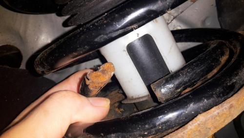

I assume that living within a 100 yards of the Irish Sea doesn't help
Well, that's pretty conclusive...
When you fit the new springs ensure all the strut base is spotless & free from dirt, before you fit the springs, grease the contact points between the metal and spring.
Springs fail in this place due to dirft getting wedged under the spring and then the black powder coating cracks away, then water gets in and the corrosion begins at that point causing fine stress cracks and then the spring snaps 😞 .......And that was told to me by a Ford mechanic when one of my springs snapped, he also said to keep the lower section of the spring clean but greased up, it'll never snap again.
Remember both sides need to be done and the tracking checked.
I had to replace mine right after getting the car, one of them totally snapped and it was making the worst squeaking sound ever. They had rusted clean through and broke.
This is exactly what mine did.
