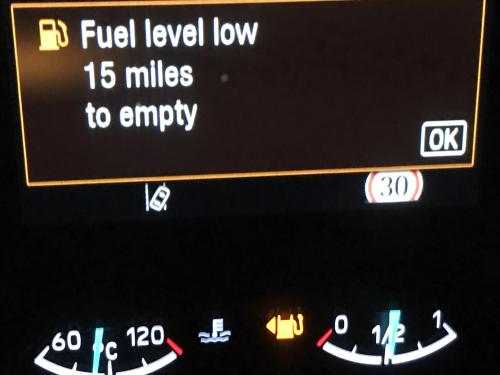

Car is back from a service where I mentioned this. According to the job sheet/invoice, they carried out an update to the ABS module. But, they also told me there were no outstanding items coming up for my VIN and no fault codes. So why did they do an update for that, but not for the fuel filter at limit warning?
Started the vehicle and the fuel gauge needle was pointing at half full, but the petrol warning light was on and reading that I had 15 miles to go to empty. Queried this and was told it was "normal after an update" and it'll "sort itself out". Seems like a load of nonsense. I filled the tank because I had no idea how much fuel was actually in it, needle is now on full and miles to empty is 20 and slowly increasing when driving.
So they updated the ABS module and broke the fuel gauge? I don't get it. Are the two things related?
I was told they couldn't find anything wrong with the fuel filter at limit warning that happens most days (despite taking it for long runs) and that I need to keep driving. Right. Like from Holyhead to Manchester and back and it did it the following week?
I was then told if I thought it came on too much, to give them the car for a technician to take home for a week or two. You are having a laugh, right? Apart from the fact that for all I know they'll thrash the (fairly new) car, who pays for the courtesy car and my inconvenience? A fob off if I ever heard one: tell you that the only way to resolve an issue (maybe) is to give your car to someone you don't know for a fortnight. I don't know how the technician kept a straight face, but I have to wonder if perhaps this was the stock answer given to anyone with a difficult issue.
Absolute waste of time.
Still, the B&O sound system was on full blast when I got in it, so I can imagine what they've actually been doing.
My car isn't clean by any means, I have a 2 year old, but the courtesy car was next level filthy inside: crisps and gunk everywhere. "We didn't have time to get it cleaned because we are so busy" she said. That's my problem why? No worries I said before I saw it. I felt like hovering above the seat like you might in a portaloo. £10 for the privilege and not as much fuel in it as she told me there was.
At the end of the day, I had to call twice to find out if they were finished with the car (head office couldn't get through to the branch, twice, sent emails and still no call back. So I turned up around 5 and on arrival, they couldn't find my paperwork.
Thanks Evans Halshaw Ashton, I won't be returning.
Quote
The update has probably reset the average fuel consumption , maybe almost zero. So the calculations for dist to empty are getting a low value even the theres plenty of fuel in the tank. It should sort itself out pretty quickly...
