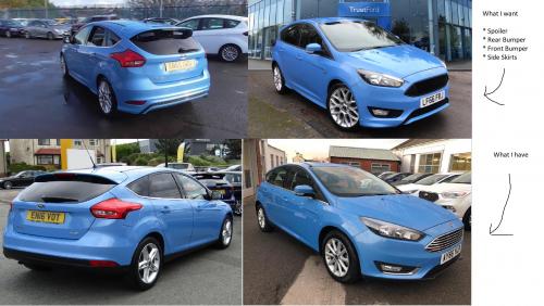

Sooo, recently I got an iceberg blue Ford Focus, 66 plate. Absolutely loving it but can’t help but awe over the ST Line body kit 😞
I know to upgrade my body kit I’d need front & back bumpers, side skirts and spoiler. I don’t know where to begin though !
I’m looking at sourcing all of these from EBay, used and to have them re-sprayed and fitted at a local body shop. But I’m afraid of buying parts that won’t fit.
I think this would be a good start
https://rover.ebay.com/rover/0/0/0?mpre=https%3A%2F%2Fwww.ebay.co.uk%2Fulk%2Fitm%2F202830162897
Can anyone help ? I’ve attached an image which will give you the idea. 😁

Why didn't you just buy an ST-Line haha.
All of the ST-line parts are a straight swap to yours though. Just be careful with the rear bumper, the one you listed has parking sensors so need might be a little unnecessary if you car doesn't have them.
It won't be cheap though. Expect to pay upwards of £1000 to get all the body kit and then paint. Unfortunately your colour isn't very popular so the chances of finding bits in the correct colour and just bolting them on is unlikely.
I have read parking sensors too, I have the titanium which is the model I wanted because of the spec. But want the st-line body, best of both lol
You don't need complete bumpers, they're the same, just change the lower sections and the grille and fog lamp surrounds, then it's just the skirts, spoiler and de-chrome and wheels, obviously

Oh really? I didn't think it was as simple as that? Can you help me in the direction of exactly which parts I need as I'm so clueless and your help would be very much appreciated. (I just don't want to buy the wrong parts)
I didn't think the rear black bottom bumper came away from the blue part if you know what I mean? Just like the front bottom grill / skirt, I didn't think that came away?
Yes, they're all separate, clip on parts, you could get second hand and have them sprayed.
I love your colour BTW, it looks lovely in ST-Line spec
Thank you! I love the colour too but I love the body of the ST line sooo much better than the titanium, but wanted the titanium spec.
So I need...
  • Rear bumper skirt
  • Front bumper grill
  • Front bumper skirt
  • Side skirts
  • Spoiler
  • Fog lamp surrounds
What do you mean by "de-chrome"?
I appreciate your help so much. I didn't think the front bumper skirt would clip away, so I was intending on replacing the entire bumper. I am excited to get it looking good. 🙂 Will post progress photos!

Correct.
Grill & fog lamp surrounds are quite cheap new.
The rest you should be able to get 2nd hand and paint.

The chrome on the doors, not fitted to ST-Line (it was on Zetec-S but removed for ST-Line.
The only thing you won't have is the black headliner

I will look into sourcing these parts then. I've been looking at the rear bumper skirt and some items have a sort of cut out I would assume is for an exhaust? My exhaust is on the opposite side.

Lots of back bumper skirts have these cut outs on them and I'm not sure why...
https://www.ebay.co.uk/itm/GENUINE-FORD-FOCUS-MK6-2015-on-ST-Line-Zetec-S-REAR-BUMPER-Lower-Skirt-Valance/402057805715?epid=1770225555&hash=item5d9c833f93:g:Q4oAAOSwebheMapZ
I'm referring to the section top right with the two holes?

I will do 😄 Thanks for the advice! I posted an eBay link above, not sure why they're missing panels?

Guys, someone from a breaker yard suggested the parts on an "18 Plate ST Line Ford Focus" (So lower front and rear skirt) would NOT fit my 2016 model?
Depends if it's early or late 2018 as that was the changeover year, is it off a MK3.5 or Mk4?
All mk3 I didn’t even know mk3.5 was a thing ?
Making me question what mine is now lol mine is a 66 plate

66 plate would be a Mk3 facelift usually referred to as Mk 3.5.

I have seen these on Ebay, same seller.
https://www.ebay.co.uk/itm/FORD-FOCUS-MK6-2015-ZETEC-S-REAR-BUMPER-SKIRT-GENUINE/183830530876
https://www.ebay.co.uk/itm/FORD-FOCUS-ST-LINE-2015-17-FRONT-BUMPER-SKIRT-GENUINE/184159064040
Reckon these will fit? The rear skirt comes with tow eye cap AND the black honeycombe strip thing they're just not pictured.
