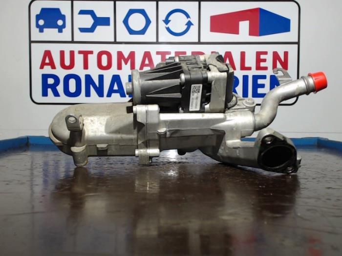

Next is to remove the EGR valve (anyone got instructions how to do this on a econetic NGDB?
its not the 2 bolt type thats sits on top, it seems to be fixed to a housing) otherwise i will remove the whole manifold.

Removed EGR and stripped down on bench. nothing obviously broken but the gaskets are not in great shape.  cleaned and refitted. no change
The EGR housing oring was pretty rough but didnt have another so refitted. no change
