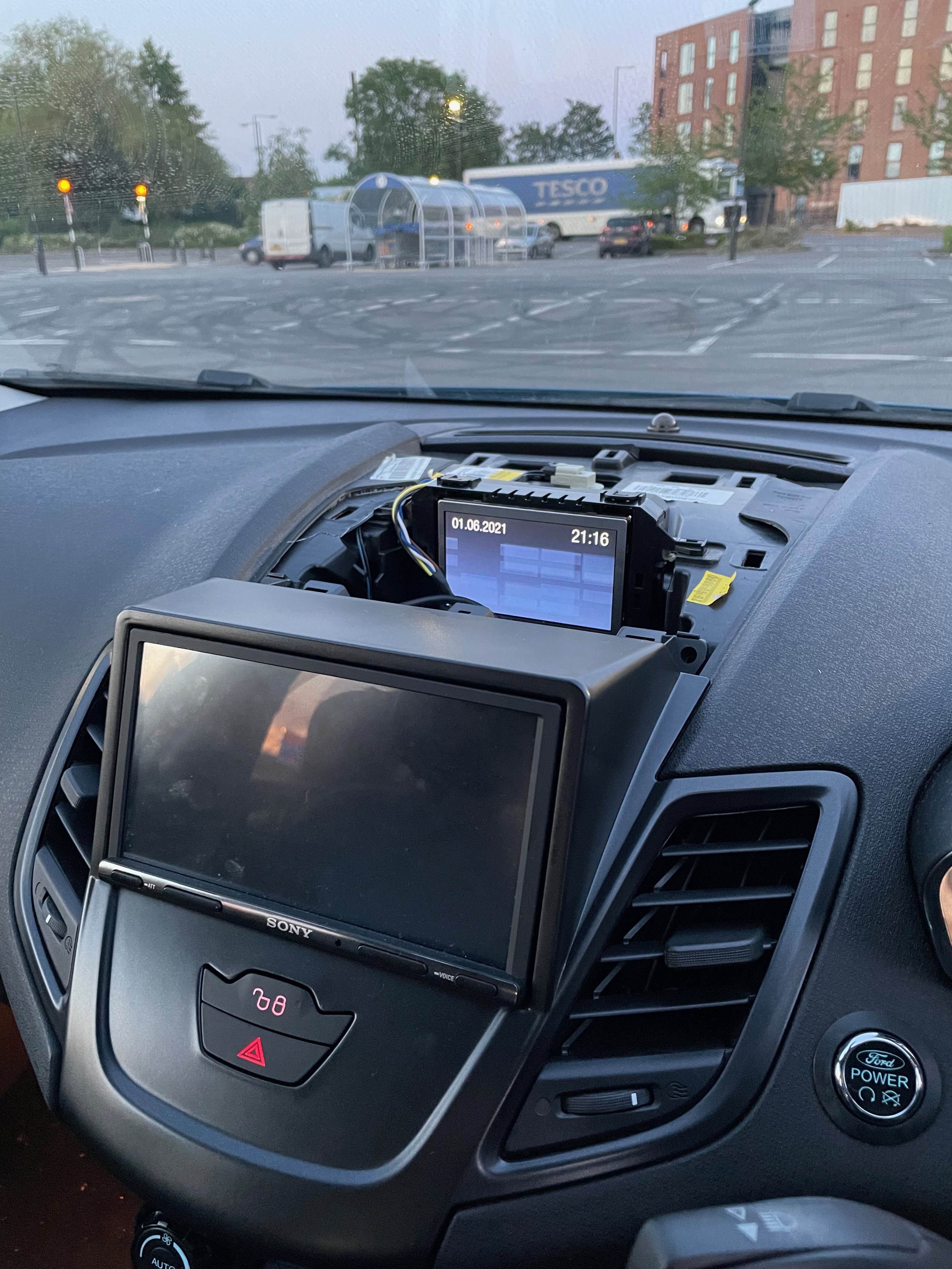

Hi all, first post here — apologies if this isn't in the right place, but I'm at my wits end with this one.
I've attempted to replace the stock Sony radio in my Fiesta 2014 Titanium with a Sony XAV-AX3005DB, and technically speaking everything* works, it's just the fitment kit I've got from Connects2 that doesn't make any sense. The car has a SYNC 1 screen (no sat nav), but the Connects2 CT23FD43 kit doesn't fit with screen in it's original place, and it didn't come with any manual/instructions at all.
The only manual I can find for the Connects2 Fiesta fitting kits mention a red screen instead of a SYNC screen — have I got the wrong part from Connects2, or have I missed something? I saw someone on here with what looked like a Connects2 CT24FD33 kit, but I don't want to buy yet another fitting kit without knowing if it'll work.
Here's a picture of the current situation:
As convenient as it is to have a huge hole in my dashboard, what part do I need to cover this up?
Thank you for reading, I appreciate it!
* Reversing camera doesn't work on either SYNC or head unit — I'm looking for a guide but if you have a link, please let me know!

An update on this: I picked up a Connects2 CT24FD33 (instead of the disastrous CT23FD43) & it fits beautifully. Haven't screwed everything down yet, but if you're looking for the fitting kit for a SYNC 1.1 display in a Fiesta mk7, the 33 is the one you need. It's astonishingly fiddly to screw everything in, and naturally there aren't any instructions, but it's relatively self-explanatory from the stuff that's in the box. There's a photo of what the whole ensemble looks like below. I have no idea why Connects2 couldn't recommend this kit given my VIN number, but according to 7zap's Ford KB, the FCDIM in my Fiesta (part number 1883244, EM5T-18B955-GD) was manufactured in a six-month period in 2014 (from 20.05.2014, to 18.12.2014). I guess they just did everything for the mk7, and assumed it would work for the mk7.5.
