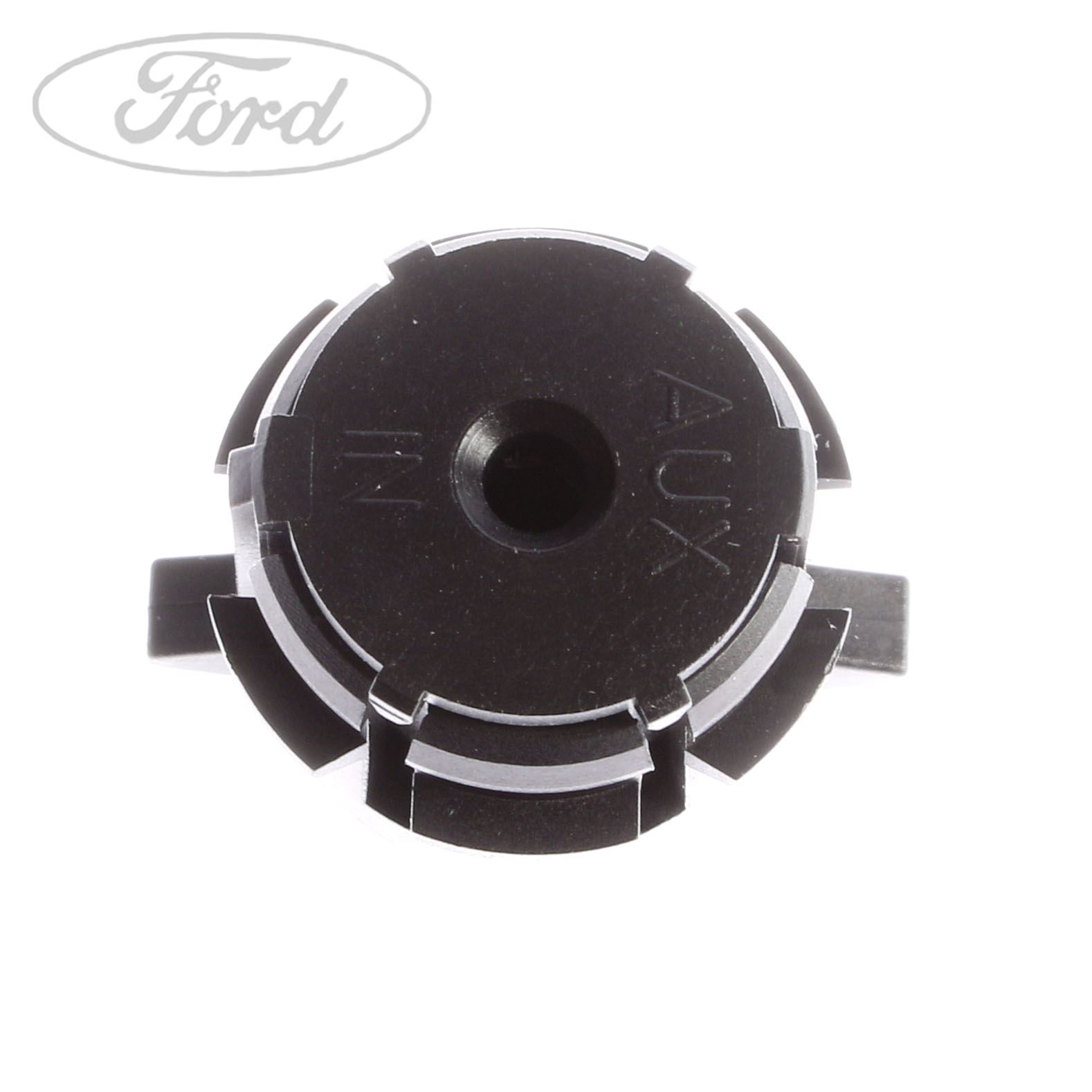

Image 1 - Genuine Ford Transit Fiesta AUX Headphone Jack Sleeve Cover Port 1365708Image 2 - Genuine Ford Transit Fiesta AUX Headphone Jack Sleeve Cover Port 1365708Image 3 - Genuine Ford Transit Fiesta AUX Headphone Jack Sleeve Cover Port 1365708Image 4 - Genuine Ford Transit Fiesta AUX Headphone Jack Sleeve Cover Port 1365708
this the socket does it go in from the bottom and still having trouble dismantling it if has to be replaced thanks again
The sockets are fitted from the front and therefore have to be removed from the front.
It is of a two part construction.

Hi I've just today replaced the aux socket! What is it you've done with the collar?...Ah, ok, you mean your new socket came as 2 seperate parts likely in this pic? And you put them together and now can't seperate?
There are 2 ways to separate them, watch step 5 of that youtube guide, but you'll need 2 really very thin screwdrivers, and it'll help to have the old one to hand, so you can see and understand  what the tabs lock into and what you're trying to achieve.
The other way to part them, is a bit risky as you could break the tabs, as the chap in the video did, but I got away with it, phew!  is to hold the socket in both hands, and to push up with thumbs and down with fingertips and force the tabs out. Like in the pic.

Remove the console, turn it over and look at the rear of the aux socket: those 2 tabs you can see opp each other are part of the top. I had to push those tabs firmly down while sort of holding the main body of the socket with my fingers. When I say 'down' I mean towards the inside surface of the console. You don't bend 'em just push. Hard. The top part of the socket will pop out, so DON'T have the console resting on a flat  surface, else it'll be prevented from coming out...put it on your lap.IMG_20240609_150535.thumb.jpg.e80e58f4530e2fe4b71654766467e685.jpg
You'll then find you can remove the main body of the socket, followed by the top bit, but from the inside, not try to lift it out of the top, as the ends of the 2 tabs, or legs,  make it hard to remove from the hole topside.
