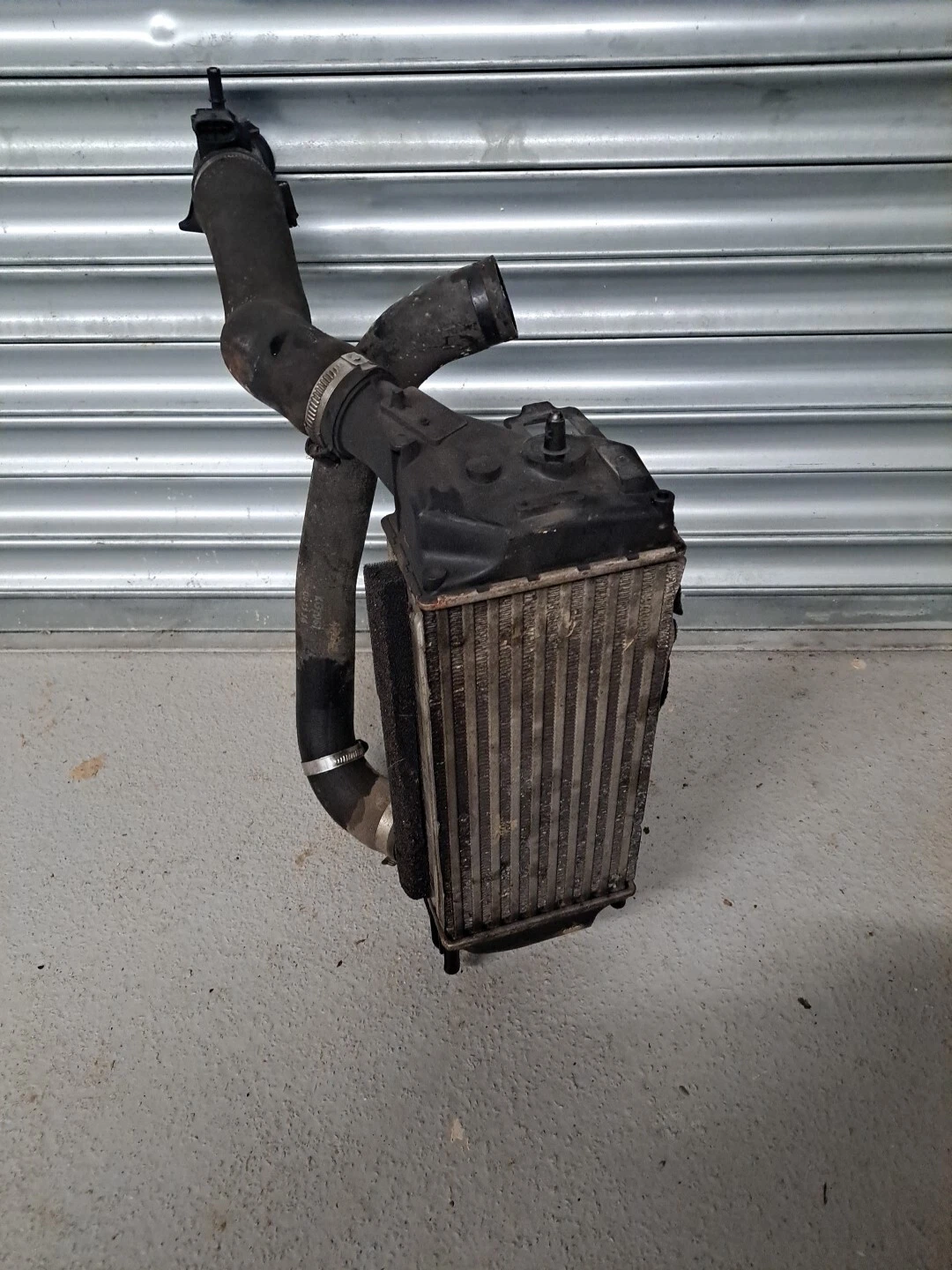

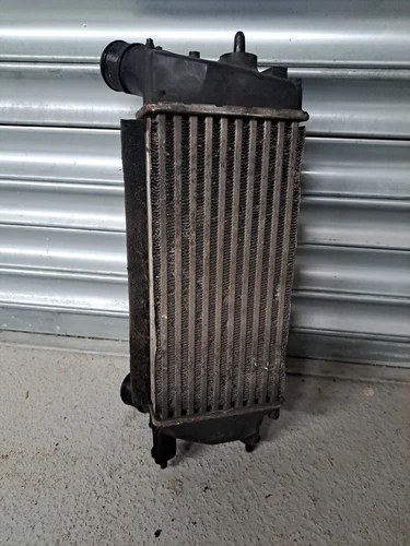

No it shouldn't move that much.  I think that's the top mounting point for the intercooler.  If so, the mount has snapped off, which explains all the movement, and the reason that the AC pipe clamp has come open at the top end.
Have a look at the big black spike on top of these intercoolers, I think that's what should be under that rubber hole on yours.

It's moulded plastic so the whole intercooler should be replaced unfortunately.
They are cheap to buy used on ebay, just check that any used ones aren't damaged in the same way if that's what you decide to do.  Also some of them have a separate fan fitted to the back, so check whether yours does or not before buying.  (The fan ones have extra brackets moulded on the intercooler so not interchangeable.)
Alternatively you can buy a new aftermarket one from somewhere like Autodoc - 0 results found for 1764929 - AUTODOC Search
Or the cheapest option would be to 'bodge' it by gluing something else on there to support it.  Or using cable ties to hold it in place.  The sky is the limit, use your imagination. :biggrin:
It's not a particularly difficult job, so can be done by a home mechanic with a bit of experience and a few tools.  Probably not a job for a complete novice though.
