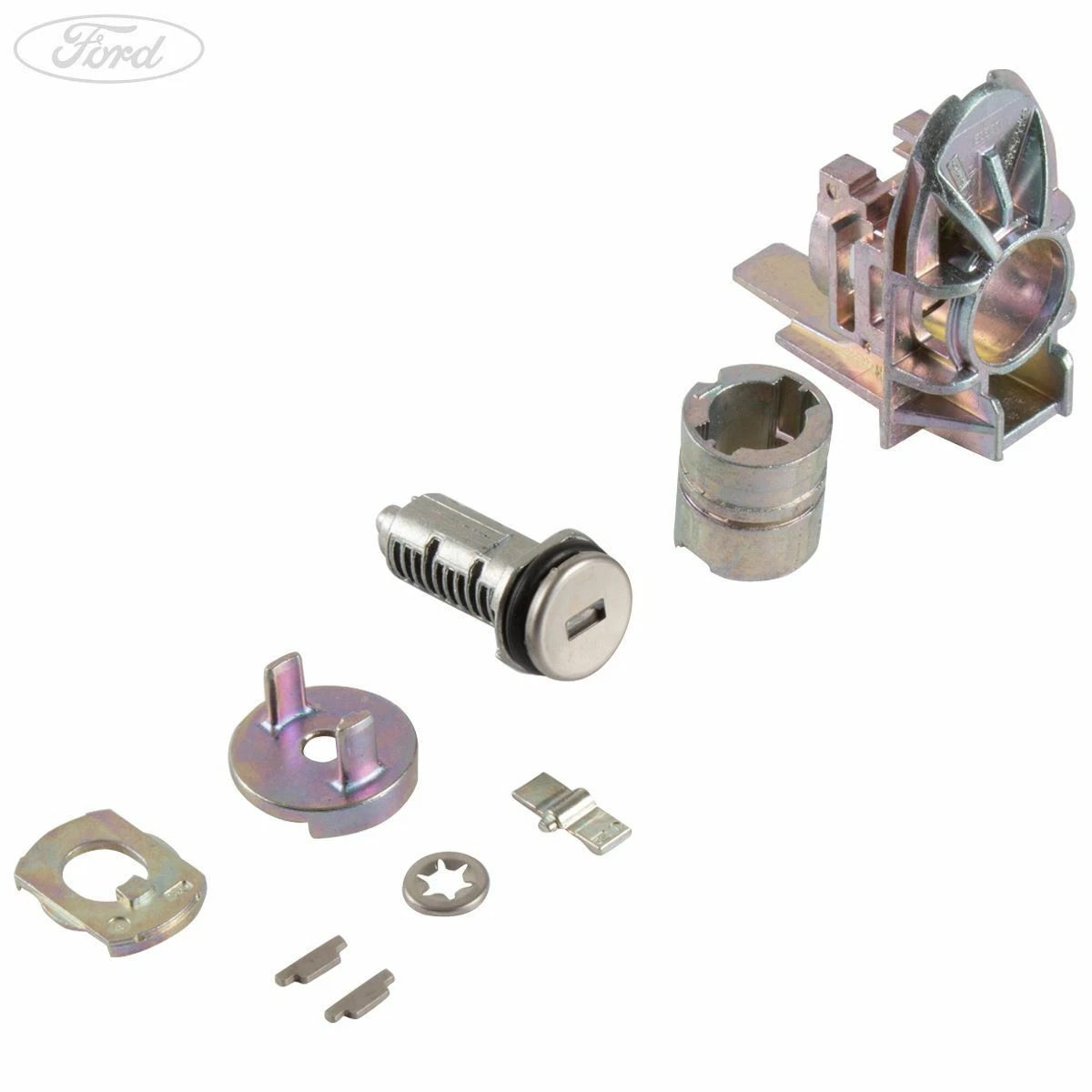

The part that's left there is the outer cylinder of the lock barrel as far as I can see.  It has a central groove around it where the securing screw goes through the side to lock it in place.  That cylinder shouldn't be connected to anything else.  The lock barrel was originally connected to the part with two posts (that's the barrel to latch connection that does the actual unlocking) using the star shaped washer at the back, but if that whole internal lock barrel has been removed, the washer must have been broken off.  If that is the case, I can't see how any further internal damage could be caused.  However, I do believe the plastic lock mount may have been damaged already by forcing the lock in too far, and that's what's preventing the outer barrel from being removed, even with the screw fully out.
Yes, removing the door panel will be the only way to access it if it doesn't come out with a firmer tug.
