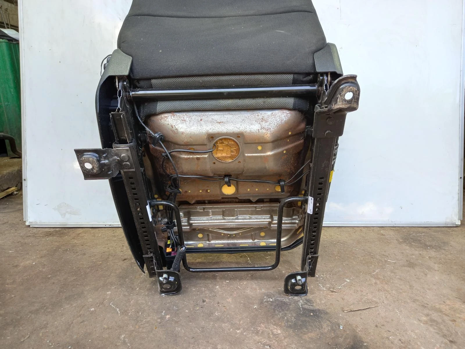

There's nothing particularly clever about the fore & aft mechanism.  It's literally just a set of holes along the rails.  The handle is connected to a set of fixed pegs,.  You are literally just lifting the pegs out of the holes to move the seat.  Then dropping the pegs back in by releasing the handle.  There is also a small rolling caster each side which allows the seat to move more easily, not visible on the picture below.
Not much that can really go wrong with it.  You could try pumping the height adjuster all the way up to give a bit more space to see, but I can't think what could break in this mechanism.  Think it just has come too far back and needs a bit of brute force to push it forward again.
