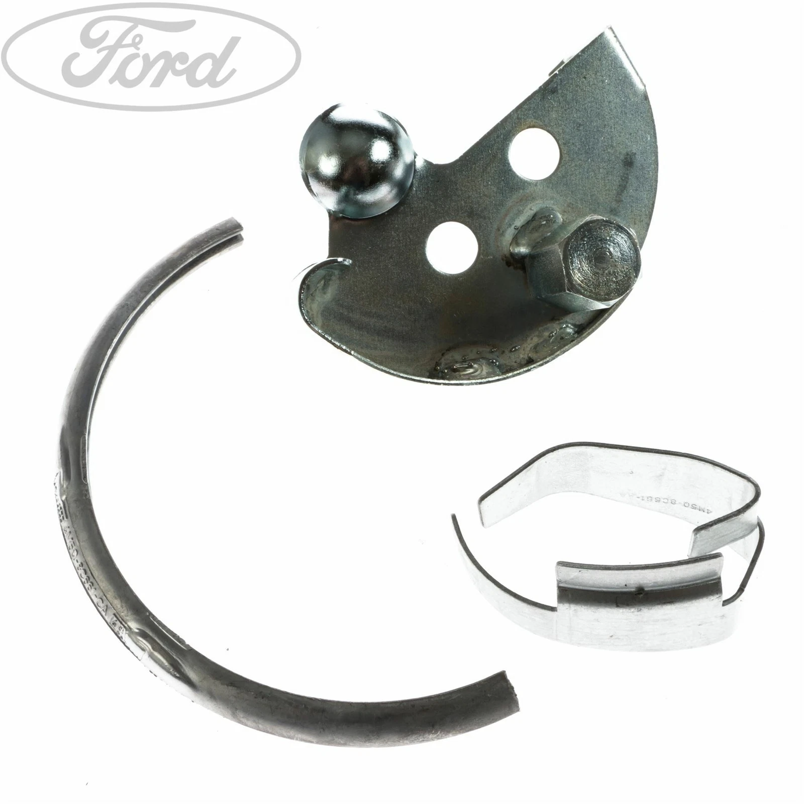

The belt on these is stretched on at the factory.  It doesn't have a tensioner and the alternator doesn't have any adjustment.  So in order to get the belt off you're meant to cut it, and then use a special tool to stretch the new one over the waterpump pulley.  But it is possible to carefully slide the old belt off the pulleys, then stretch it back on using a flat blade...but only if you're very careful lol!
Special tool here:
Genuine Ford Focus MK3 Focus C-Max MPV Drive Belt Kit 1708273 - Picture 1 of 4
