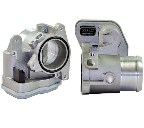

That is the intake air temp sensor.  But those codes aren't suggesting that to be the fault.  They are suggesting the throttle body to be at fault.  (Part number 1566190).
On this engine, that sensor is also bolted to the side of the throttle body.  You can see the two holes here, larger one for sensor, smaller one for bolt.
THROTTLE BODY FOR FORD MONDEO MK4 S-MAX 2.2 TDCI & MITSUBISHI OUTLANDER 2.2 DI-D - Picture 4 of 11
It was the flap in the throttle body jammed, not fully closed, managed to free the flap and give it a good clean - it seems to be fine now👍
