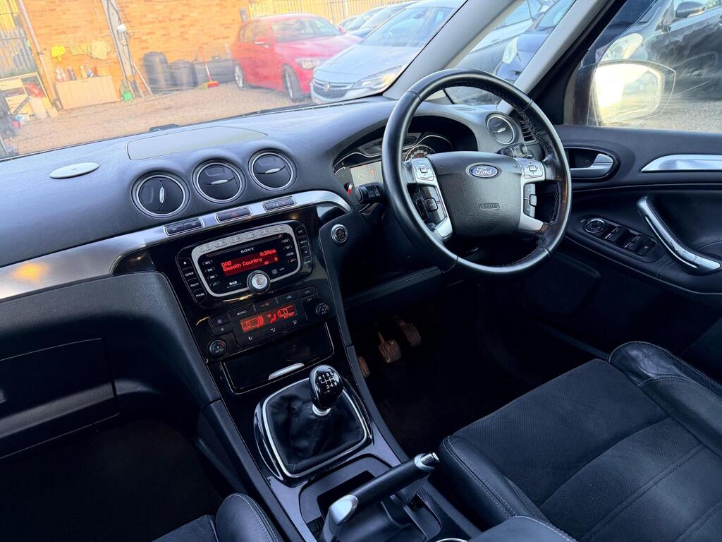

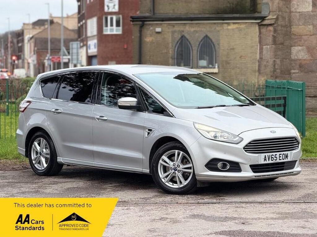

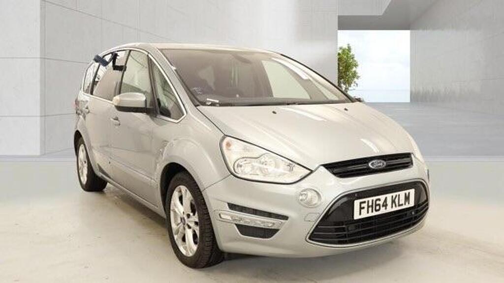

2015 is the crossover year between Mk1 & Mk2. Can you confirm which yours is?
How can i tell?
it looks from the V5 like its a MK1
They look completely different inside and out.
Pre-2015
Front Right
Interior Front
Post-2015
Front Right
Steering Wheel
in that case, definitely pre-2015
the detail over the front wheel is a givaway
