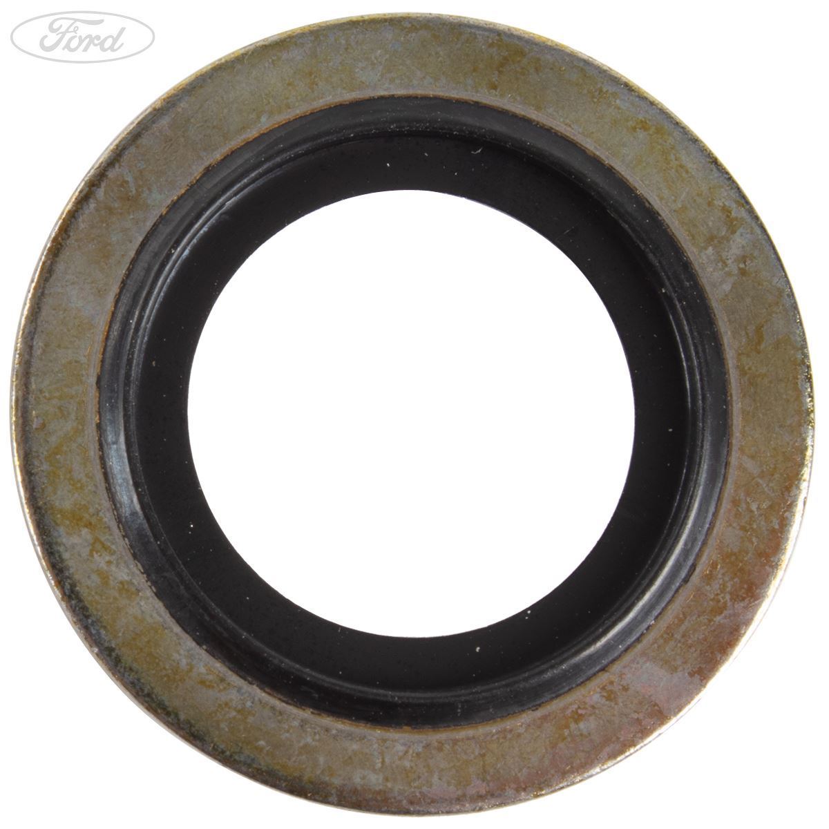

Thanks for the info you gave me, I got in contact with Ford via their EBAY site. I decided to buy OEM Banjo bolts 1337174 from there. I cheekily asked if they sell the Seals for these Banjos and they came back with this new part number 2046360. Which is also a bonded (Dowty) seal. I've not fitted the OEM parts as yet but I have been assured they are correct parts by Ford, Fingers crossed.
Its worth noting the new part number for the next person that needs help :)
Bonded Seal Ford Part number 2046360

I bought the new Banjo and seals from Ford via Ebay and there were fitted today. Sadly the oil was ***** out when the engine turned over. We checked and by chance I bought two lots of seals and the second pair leaked too. Whilst inspecting the bajo I noticed the new one was slightly different length and as a last chance, we fitted the new seals but with the old banjo. Horrah all was leak tight. That was a tense hour!!!
