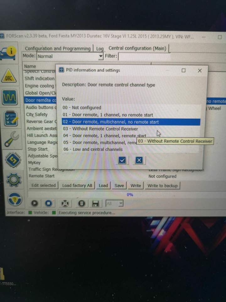

On a German forum, I found some very useful information. It seems that the car is equipped with everything necessary, the only issue is a software limitation. Specifically, the "Door Remote Control" is coded as "Without remote control." This can be modified using ForScan, and it should be set to "02 - Door remote, multichannel, no remote start." Then, the only thing left to do is to program the new remote key.

I have not done this myself but a picture of this option from FORScan is available in the same topic.

I can confirm that I managed to do this change by myself. The only thing you need to do is to configure the Door Remote Control using ForScan and then program a new remote key using the 8 time ignition on/off cycle. Also I have moved the chip from the old key to the new one and now everything is working fine. All the cars seem to be equipped  with a remote control module, at least on the facelift version.
