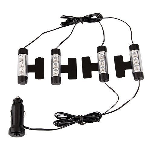

Hey guys, I decided to go for some footwell lights, but rather than making them as shown in Lenny's build thread, I bought a premade one, which I noticed has a 12V attachment to the end of them, 41DdEXbJDCL.jpg
(Sorry the pic is so large :S)
I'm wondering how I can change this from having to be plugged in to power to switching on with either the lights or with the courtesy lights, so they fade after the doors are shut. any ideas?
Chop off the connector and wire it to the bulb holder in the interior light
how would I get it up there?. I know I can run it up the frame 'arm' by the door, but how can I get it across the roof?. Or is there a easier location?
easy peasy. the lining across the front allows you to tuck the cable inside and to the light. i used a cable tie and attached my aerial cable to it and pushed it through the gap (removed the light) and then fed it through. the rest of the cable can then be tucked in neatly.
