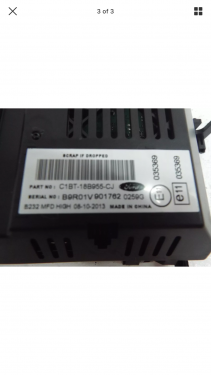

i done this in my girlfriends car 63 reg fiesta with blue screen. kept the radio and fascia then bought a high mfd screen began with c1bt and it was manufactured in 2014 but the surround  that goes over the screen is different. 10 minute job at most to do and everything works as it should.

hi. yes its just plug and play. i bought the screen from ebay but i bought the surround from ford (about £48) as its different with the colour screen than the blue screen one. if you look at yours its curved at the sides where the colour one is square. the part number for it is 1804229. its held in by 6 clips you just pop them off.

Hi, I know I’m late to the party but does the serial number of the screen have any affect, does it need to be a certain type?
If I remember correctly I just looked on ebay for a fiesta radio with the colour screen with the manufacture date on the back which was close enough to the date on the black screen I replaced.

Thanks for replying, I have tried one display already which was the same year but newer (8 months) than my display which worked but caused my car battery to drain. I’ve now purchased a very slightly older display (two months difference) so I’ll give that a go.
