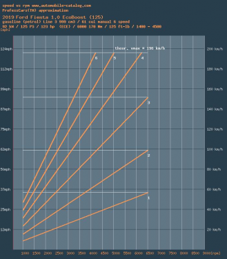

these are the graphs for RPM vs SPEED for every gear, these are two graphs for the 5 speed manual and the 6 speed manual , I couldn't find a graph for the 6 speed automatic 🙂

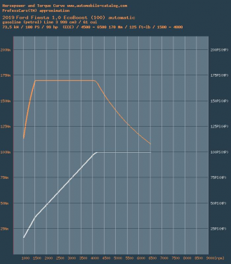

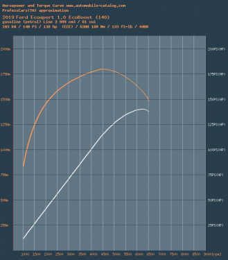

These are the horsepower/torque curves for the Ecoboost 100, Ecoboost 125, Ecoboost 140 🙂 note the power band for each engine 🙂
Thanks for those @Eng_Ahmad1986, I find these things most interesting. The power/torque graphs in particular confirm the way the different engines feel to me - the 100/125 reaching maximum torque quite abruptly, in an almost diesel-like way, the 140 more "rounded" (like the curve) and progressive.

Thanks for that and the graphs, very interesting.
this is a very good website for calculating speed vs rpm for different gears , just supply the gear ratios and your tire diameter, it can be handy when you change your tires to a size other than factory specs to know your actual speed according to the tires installed 🙂
