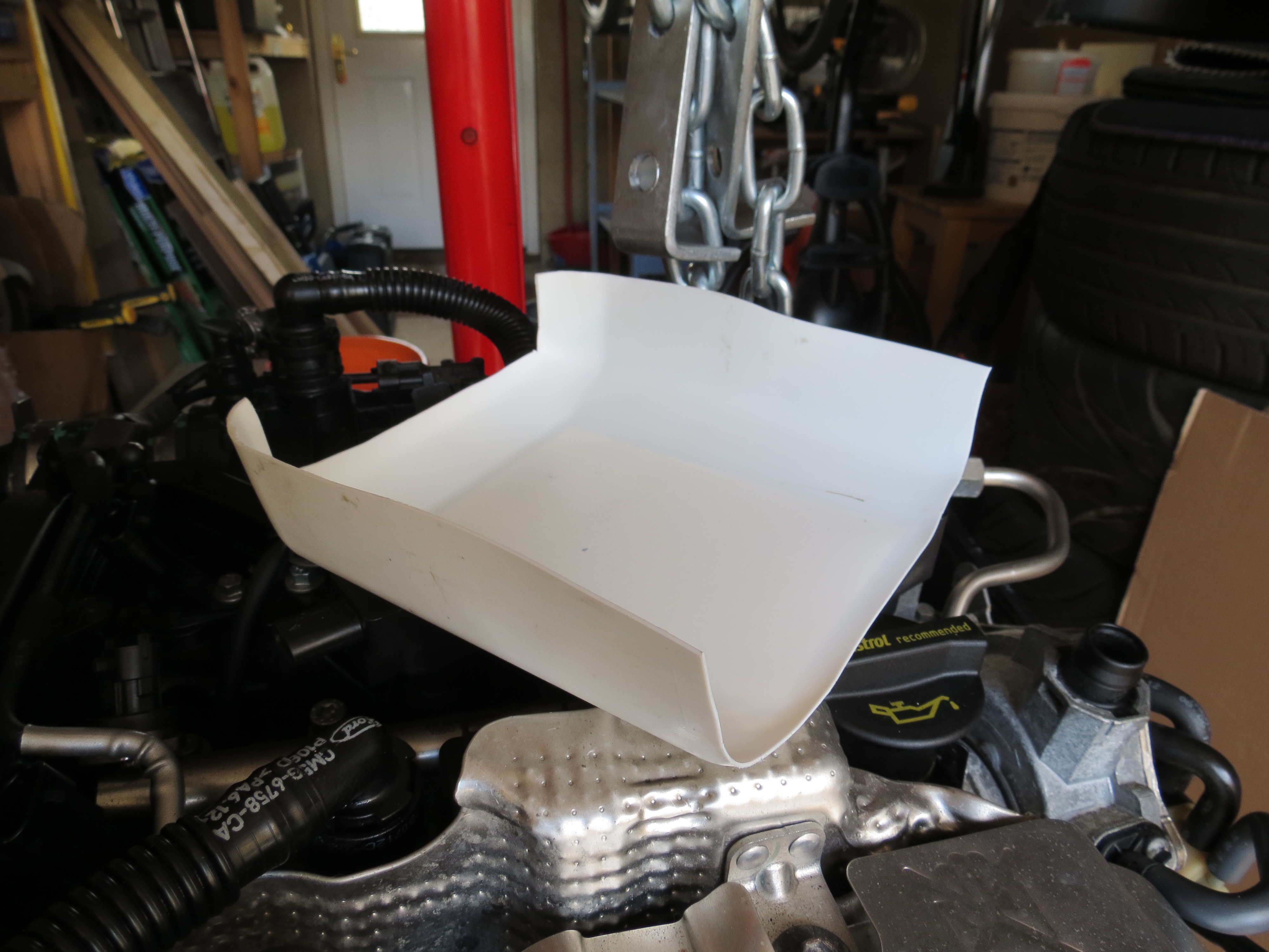

Now that I've got a spare engine to play with I took the opportunity to make an 'oil catcher' out of a old bottle:
Does it work? Well, admittedly I haven't tried it yet. I'll report back in ~6 months time!
think you will find the driveshaft and front subframe will be in the way, the main problem everyone finds is the oil drips on to the driveshaft support bearing and housing
You might be right but I think it should sit forward of the subframe although the driveshaft may sit too high to allow runoff (the right way!). Next time I'm underneath I'll give it a try - I'm planning on replacing the brake fluid soon so will give it a go then.

Just done this job on a 1.0 Eco B Max. Yes the oil does pour out of the filter all over the drive shaft. I wondered about some form of catcher as illustrated, but he is only clear route to remove the filter was from underneath and that tray would obstruct it!?

Since first posting I fabricated a kind of funnel out of the side of a plastic bottle and wedge it on top of the oil cooler before spinning the filter off. This catches any falling oil and diverts it over the drive shaft bearing into my container. I've got used to it now and it isn't as much of a faff as it was at the beginning.
