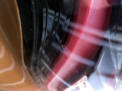

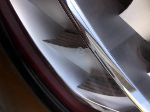

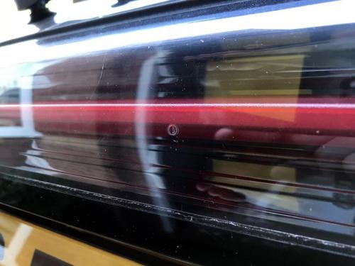

Here are the marks on the rear light perspex covers - they are just too sharp and deliberate to be a by-product of production processes - did the designer intend them to be drilled out like the Land Rover covers?
First O/S tail light:
Then the tailgate cluster (there are several of these indents I have shown the N/S one here):
Apart from needing a clean, my lights are the same, sharp edges to the hole and not drilled out...
Their location makes no sense for a drain hole. Maybe it was a riser in the mould in order to guarantee the plastic flowed onto the mould without distortion due to cooling and flow. Not saying it is, but I would have expected a breather/drain to be at the bottom where water would drain and there was no chance of it flowing in as the water beaded down the outside surface!

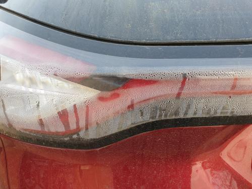

On 4/16/2019 at 2:47 AM, KugaEdge said:
20190415_172904.thumb.jpg.7f14893a8db23bebdf6622b94d6962de.jpgimageproxy.php?img=&key=ab107308399acee6imageproxy.php?img=&key=ab107308399acee6Hamster, I  know for many it isn't a fault, a small amount of condensation is the norm and is acceptable.
However this really isn't acceptable and in my view is a fault:
