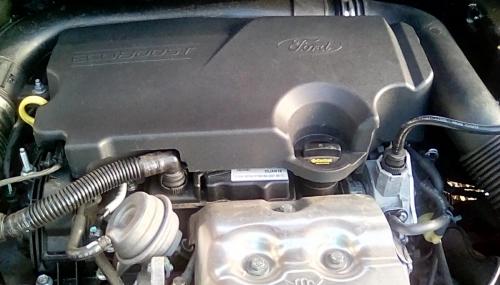

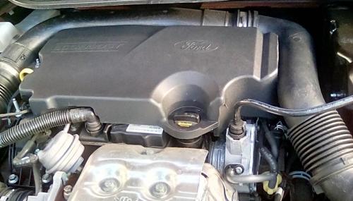

Took piccys of cover trimmed and fitted 🙂
TF63skh.jpg?1
Odn5W2j.jpg?1

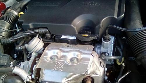

Some shots of mine (reg March 2018) for comparison - be interesting to see if there are any obvious differences to a 2019 model. The build date on the engine sticker is actually 25 Jan 2018.

So, got this little job done today, along the lines suggested by @robbyvrs (thanks Rob). As I have to park my car under a few trees, hopefully this will stop leaves and other "tree bits" getting deposited around the coil packs etc!
With the benefit of hindsight (wonderful thing) I reckon it might be possible to make an even neater looking job by cutting from the bottom to within approx 5mm of the top of the cover and then making a horizontal cut, so the cover would still look complete from above. I think it would be a bit of a faff though.

5 hours ago, Eric Bloodaxe said:
Hi Eric - do i see your cover not sitting flat at the back (just above the ecoboost logo)where it meets the top pipe?
I didn't notice mine being the same until the other day and when pushing it down to locate on the peg/ fixing it wouldn't seat properly so i trimmed a little off the bottom (can't be seen when fitted) so it now sits flush
The last St-Line i had (125 which shouldn't make a difference) the cover i bought for that was a perfect fit without any trimming at all - weird?
9 minutes ago, robbyvrs said:
Thanks, Rob. I had noticed that but as yours was the same in your pic I assumed it was ok. I'll give it a trim tomorrow!
