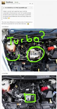

@TomsFocus Hi again, sorry to bother you - just want to confirm I have picked out the turbo! My engine is identical to the top picture you posted, confirming I do indeed have the ecoboost
Yep, that's it. :smile:

Thank you, Tom. Compared mine and my friends engines as he came over one day, has actually pointed out that the metal ontop of my engine is not actually the turbo and proceeded to say that we both have the unturbo'd versions, so I give up now 😉
Ok, rev the engine slightly with the bonnet open and listen for the slight whistle you get from the turbo. It's not very loud but you can hear it. You definitely have the turbo version as seen in the pics.
Also, get him to go out with you on a drive, find a nice 60 or 70 limit road and give it the beans. You can feel the turbo kick in.
Then do the same run in his car and you'll soon see and feel the difference.
Haha I tried that already he is just so adamant he's correct. I've given up! 😄 Hasn't affected our friendship I just find it funny how he thinks he knows alot about cars, clearly not 😉
He pointed out that because I don't have the big black cover that says 'ecoboost' mine can't be the one, I've attached an image to explain what he meant. I just said to him it's because mine was the earlier version! 😄
Most of the EB engines do not have the cover on them. Mine is a late model mk7.5 and has no cover on the engine. A few people buy an aftermarket one but afaik, Ford do not fit or supply them.

We have a 2019 1.0 ecoboost.  It has no engine cover.
5 hours ago, GarethW99 said:
 I ain't really savvy with the underneath of the bonnet, I am quite amazed how a rectangular bit of metal on top of the engine is the turboboosted part.
The “rectangular bit of metal” is the heat shield over the turbine and exhaust. The turbo is noted in the photo and how it works in the diagram.
The 1.0 Fiesta doesn’t come with the engine cover as standard. Many people add a Focus 1.0 engine cover for neatness.
