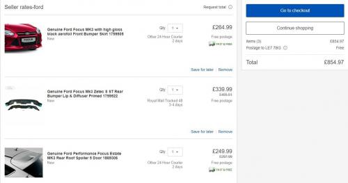

Done a bit of searching about and it seems I've found the right parts. I don't think the prices are too steep for the rear bumper and skirt or the spoiler, at least they are genuine OEM Ford kit.
The front spoiler and lip though, that's a bit pricey. I might buy that second hand. Does this look like the right kit ? I'm not too bothered about the side skirts for the time being, I don't really see much difference between them and the standard ones.
Does this look about right for what I'd need?... How much do you think a bodyshop would cost for painting and fitting the parts ?1213062148_ZetecS.thumb.jpg.1b9aba1c182a07c279bf0c05802a8536.jpg

Looks good to me, I managed to get a kit for my old Focus MK3 from someone selling on this forum, you'd be better buying them second hand in any colour and getting them all sprayed at a bodyshop will work out cheaper still. To get all them parts sprayed to a excellent standard I would say around the £700 mark.

Thanks, thing is though from what ive seen on ebay, apart from the front spoiler skirt, the rear bumpers all look a bit scuffed and marked up, I really need them looking mint, if I buy second hand and they're generally a bit scuffed and have marks on won't they need prepping first which will add to teh cost?

Price I mentioned would include the prep pal

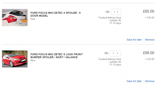

Cheers. Have found these but the prices seem too good to be true?
can find the rear diffuser second hand, there's a few in decent condition for good prices, but cant find a rear Zetec S bumper second hand.
am i right in thinking the front spoiler just clips onto the existing bumper I have or is my existing bumper a different design to the Zetec S front bumper?

The quality of those will be rubbish, they aren't genuine parts, hence the price. :smile:
Ford won't be interested in modifications, you'd have to ask an independent bodyshop to do the work.

I can tell you the parts that are from that company are rubbish and suffer quite bad from cracking after about 12 months due to heat cycles e.g. weather going hot then cold. Genuine parts require no extra holes as all the holes are already in the correct place and simply connect to your car, the whole process for me only took around 1 hour 30 mins. Side skirts can be a bit fiddly but still pretty easy, I'd recommend a flat head screw driver with a cloth wrapped around the tip to avoid scratches when removing all the old clips

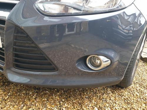

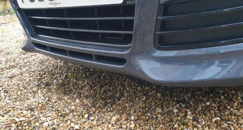

20190503_182301.thumb.jpg.c3af3ed6aacb858f15d14e3c14dfe052.jpgthanks, are you sure i dont need an actual Zetec S front bumper though, arent they different to this? the lip of my bumper looks like its moulded with the rest of the bumper.

The front is just a splitter underneath your bumper is a black piece of plastic trim going pretty much the full length of your bumper, the bumpers are the exact same it's just a splitter that is added on
