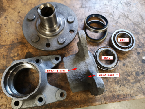

I am going to assembly rear hubs with bearings and want to make sure I do it correctly, i.e. mounting the bearings with the correct side in correct location in housing.
Bearings named 1 and 2.
  1. Should 1 or 2 be on the B (the inner side)
  2. Should 1 or 2 be on the X (the inner side)
I hope I explains it, if you have a instruction with exploded assembly instructions - it would be great 🙂
1 should be on the inner side and 2 on the outer side. number 2 should be slightly cone shape
Thanks @JAKE191 and that should go for both sides, right?
That seem the only logical option to be able to clean and lubricate the bearings
Hi yes same both sides
