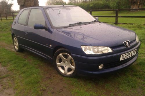

mine was that colour i scrapped it cos it stalled everytime i pressed the clutch LOL
