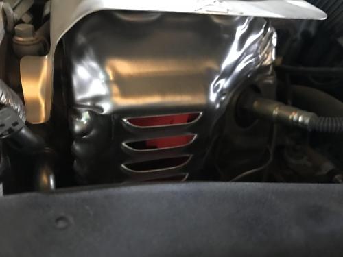

once ( and I was stupid at that time 😄 ) I pushed the accelerator pedal WOT for about on the sixth gear at 3500 RPM, at speed about 180 km/h for about 10 km , I wanted to see how see how is the engine torque at that situation ( I told you I was stupid as sure I was lugging the engine that way 😄 ) and then I stopped, without turning the engine off I opened the hood, only to see the turbo glowing red ( shown in the picture ), I kept it idle until turbo cooled down completely and the radiator fan switched off, then I switched off the engine, since then I'm extremely worried that such a thing could have damaged the turbo or shortened its life, knowing that its a stock map and my engine is the 100ps version , and that also made me wondering about the exhaust temperature of that engine , and if there is enough temperature to turn the turbine housing red like that, how was the turbine inside, it may had been cooked 😄

I don't think that's particularly stupid tbh…  It's only 110mph for those of us stuck in the past lol.  If you bought one of these in Germany you'd expect it to handle 100mph+ on the Autobahns for miles and miles!  :unsure:
It looks like the heatshield has actually done a fantastic job of holding all the heat in! :laugh:
But don't you think that sustained WOT on the sixth gear at 3500 RPM for about 10 km isn't considered Lugging ? or at least may have shortened the expected life of the turbo somehow ?
To be honest, I've never owned a turbo car where the turbo didn't glow quite a lot when the car is pushed.  My S4 that I had just before the Fiesta could be seen glowing from under the heat shield pretty easily.  And my older Astra VXR had a turbo that looked the same as yours after driving 6 miles at 60mph in 6th gear to my girlfriends house!  Haha.

Your car will be just fine. If the turbine sustained any damage you would notice it immediately 🙂.
Also, i guess WOT would've taken you to way higher RPMS so no engine lugging was sustained in the long term (also, dont worry too much about that lol)

what a relief 🙂 thank you very much both of you my friends 🙂 @Eliterox and @Daggerit
