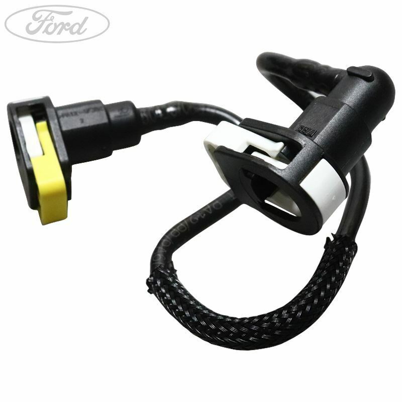

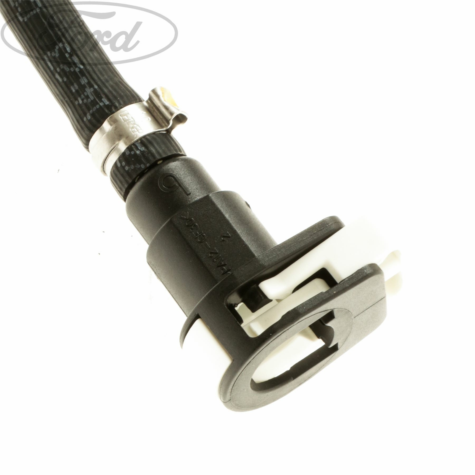

TomsFocus Posted July 6, 2022 Share Posted July 6, 2022 Think it might be this one? Only £30 as well, bargain! Genuine Ford Focus Mk3 C-Max 2.0 Duratorq Diesel Fuel Hose Tube 1703743 | eBay 2 Quote Link to comment Share on other sites More sharing options...
F0CUE Posted July 6, 2022 Author Share Posted July 6, 2022 1 hour ago, TomsFocus said: Which part is it attached to? I can't seem to get perspective from the picture. Ford may still sell it as part of something else (pipework etc)... As for those pipe clips, you won't be able to get them back on tightly after removal. Best to replace with a small jubilee for DIY jobs. 1 hour ago, TomsFocus said: Which part is it attached to? I can't seem to get perspective from the picture. Ford may still sell it as part of something else (pipework etc)... As for those pipe clips, you won't be able to get them back on tightly after removal. Best to replace with a small jubilee for DIY jobs. It's straight at the top and had one of them hump style clips holding it on then the other end is attached to hard pipe. I have seen that £30 one it's nothing like it. Quote Link to comment Share on other sites More sharing options...

TomsFocus Posted July 6, 2022 Share Posted July 6, 2022 Ah ok, I think it's this one? Only available as part of the hard line though. Genuine Ford Fuel Feed Tube 1739562 | eBay 1 Quote Link to comment Share on other sites More sharing options...
F0CUE Posted July 6, 2022 Author Share Posted July 6, 2022 1 hour ago, TomsFocus said: Ah ok, I think it's this one? Only available as part of the hard line though. Genuine Ford Fuel Feed Tube 1739562 | eBay Christ would have to strip the whole front end to get that in there 😂 the space is very limited I had to remove brackets to get more space. Or pay over £80 just for a connector to take off. @TomsFocus Have u any idea of the diameter of the fuel line? I know the connector is 7.89mm to the pump but the line no clue. 2 Quote Link to comment Share on other sites More sharing options...
