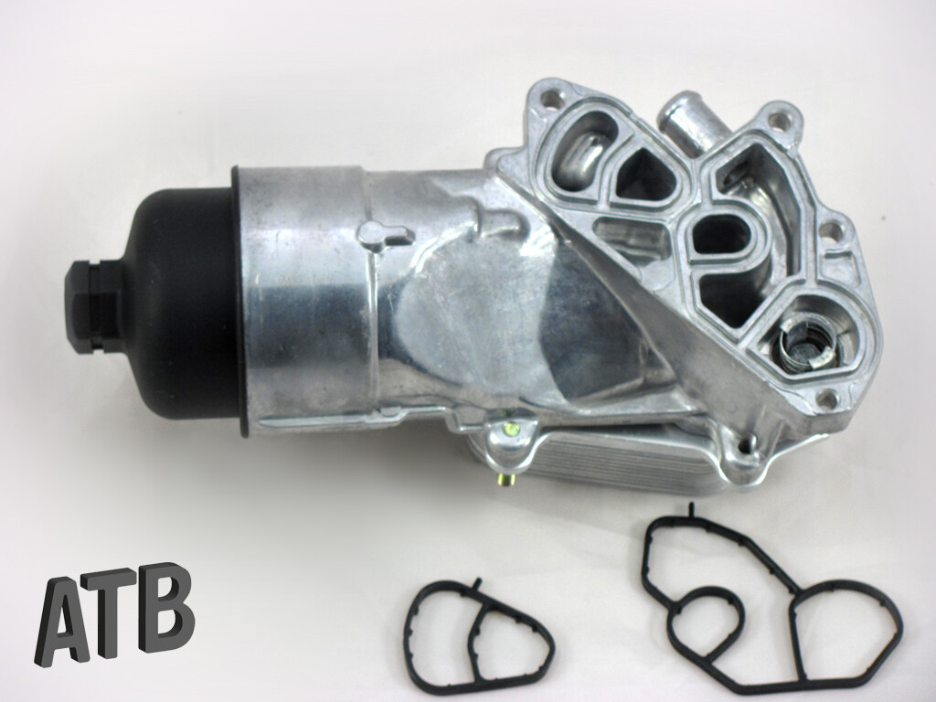

Ah, you're half right.  There is only one coolant pipe on these filter/cooler assemblies.  (Top of picture here).  The other coolant hole is on the flat surface.  That does make testing more difficult.  But it also means that the rubber gaskets behind the oil filter housing could fail and cause the symptoms you're having as well as the main cooler block.  I would want to remove this whole assembly myself.

It's me again, a question crosses my mind, know where I can find document or other to know in which port the oil or the coolant is supposed to be?
For the oil filter housing or something else?
On the picture above, I think the top two are for coolant.  The bottom 3 are for oil.  Judging from this used part.  I was also wrong about the hose before, that is for oil on these, it's the turbo oil drain pipe.
