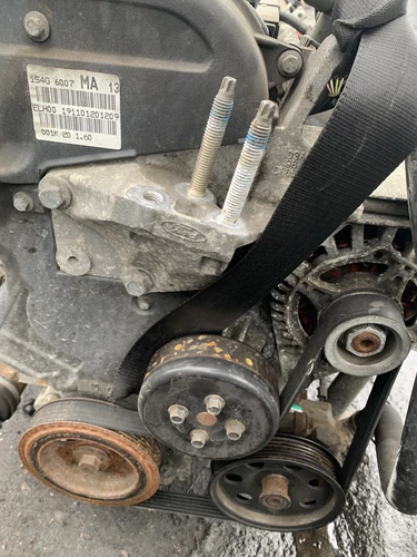

Does it have AC?  If it's a non-AC model, it may not even have an auto tensioner.  (Which begs the question...what are you trying to undo!?)
Yes, the bolt will loosen on a tensioner if turned that way, it does hold the pulley wheel on.
The waterpump pulley can be seen here with the 4 bolts in the centre.  That is the same regardless of aux setup.

Yep it does have ac trying to loosen tensioner so I can take the belt off in order to remove the alternator
Ok, if you can post a picture of your setup that may help us.  I'm struggling to find a real life picture of one with AC on ebay.  The parts catalogues aren't always correct and the Mk2's moved to stretch belts without the need for a tensioner so I'm more familiar with those.
The tensioner moves in an arc shape, so it's more difficult to start from some angles than others.  Though if you've seen an identical one on Youtube then that should be the right method.
Don't think I can offer anything more than before.  Either get more leverage on the tensioner or remove the belt over the waterpump pulley instead.
