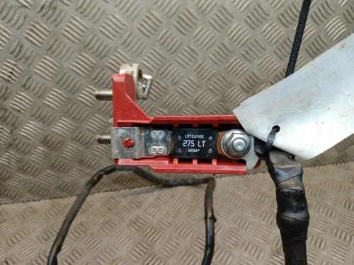

Edit - I've just remembered there is a fuse on the positive battery cable for these. I can't really believe that would have blown from just moving the car slightly. Might have cracked at one end though.
FORD FOCUS CABLE BATTERY TO STARTER MOTOR MHEV LX6T-14300-UAAD MK4 2018 - 2024 - Picture 5 of 12
