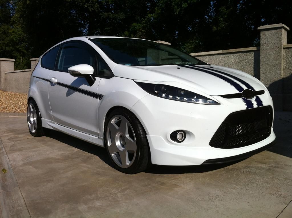

this is probably the biggest update I have had so far, purchased a set of new (well second hand) wheels!
the night I got them
I washed, detarred, iron clensed and used the below on them before I put them on the car, hopefully brake dust shouldn't be a problem for a while
streetpacks and spacers off, new wheels on
I'll hopefully get a few better shots when the car is clean and I can rope a mate into taking some proper photos not off a phone camera.
well pleased with them though
Love the wheel's. Very clean, especially for second hand.
cheers bud, yeah they are only 4-5 months old so they are in really good condition.
They are sitting better now the springs have settled down a bit again, i'm really happy with them
