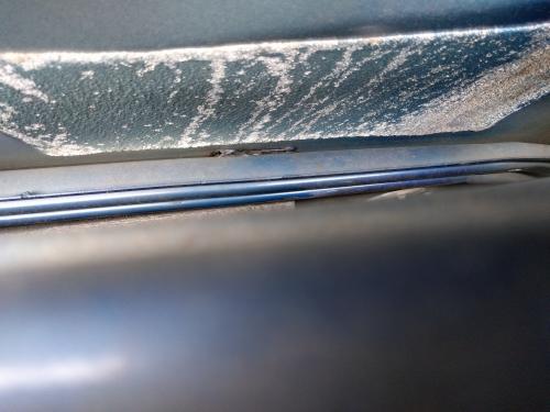

I had an annoying rattle from what seemed like the driver's side window. It turned out to be a failed tack weld inside the door where the side impact bar meets the door skin. The sound propagated to the top of the door/window. I could also hear the rattle when shutting the door.
I managed to fix it by removing the door card and window, then packing the small gap around the weld with metal epoxy.
The attached image shows the view looking down between the door skin and inside of the door with the window removed. The weldt that failed is in the centre of the image.
I think i have this or similar on my drivers side door, very metallic rattle on some music and when sometimes shutting the door, have put sound deadening on some of the inside of the door with what i can reach through the speaker whole but will see if i can see anything like this tomorrow, if i tap the outside of the door near the middle it buzzes so am assuming it may be this
Hi Again, also did you have to take the inner door panel off to do this?
