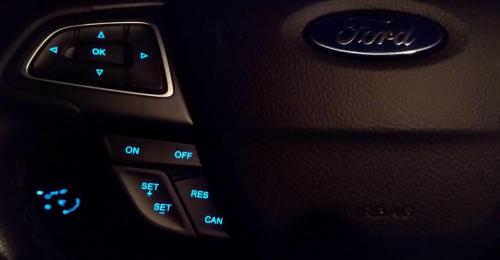

    SUCCESS! INSTALL/UPGRADE COMPLETED CAN CONFIRM FULLY FUNCTIONAL CRUISE CONTROL AND SPEED LIMITER WORKING!  All for under £100.00 Fully OEM vs Third Party who wanted £500+ I cannot confirm if this

  • Cruise is now activated! After many failed attempts with both Focccus and Forscan, I managed to borrow someone's UCDS dongle and software and we activated cruise in minutes on my car. I tested it

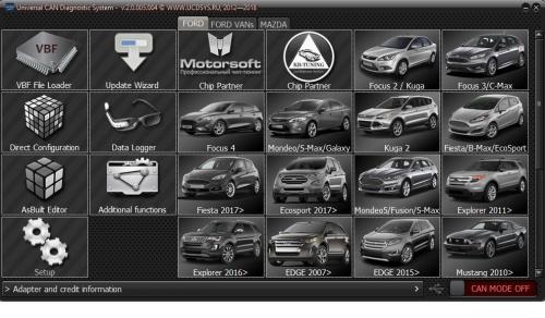

Hello, I have tried to activate the Cruise control in February 2018 without results… somebody figured it out yet?
yes you need the UCDS adaptor and software as no other program can do this
Okay where I find all this?
https://www.ucdsys.ru/

I ordered the level 1 module, they provided a demo licence with 20 limit, you'll need to get this of them as its tied to your module, thats if you havnt ordered the extended licence.
its straight forward and user friendly, god bless the ruskies :) let me know if you need anything sure.

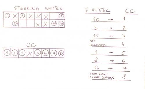

On 12/15/2018 at 4:49 PM, Frank125 said:
I've received quite a few messages regarding installation/enabling Cruise Control on a Focus 1.5 TDCi.

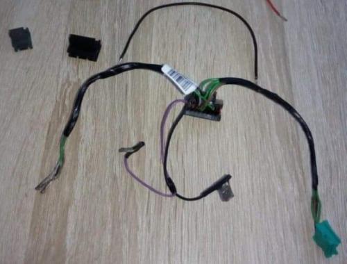

As mentioned before I've added CC switch(FINIS 1851411) to my existing steering wheel(SW).
Also worth noting that for Focus 3.5 ford doesn't supply wiring loom for CC however as you'll see in the next description there is a way to get around that.
These were my steps:
I will not get into details on how to disconnect battery, remove trim and airbag. It has been described on this forum more than well.
Once faced with wiring on SW it will become obvious that to the left SW switch(this switch will be replaced by new CC switch) leads 4 circuit receptacle however to the new CC switch it is necessary to obtain proper 8 circuits (for 8 pin) receptacle. This connector is Molex MINI50 0347910080.
You'll also need to get proper connectors for crimping on both sides (note that 16 pin connector on SW - eg.RS 718-7145 has different ones than 8 pin on CC receptacle - eg.Mouser 560023-0421).
Connect wires according to the wiring schematic below. Colours don't matter, follow the location of wires.
You'll also need to cut a chunk of the steering wheel to fit new CC switch.
Put it all back together. What follows next is what probably most of you are waiting for.

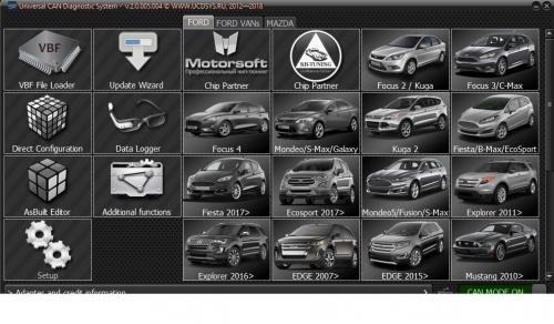

I used original UCDS software which is very straightforward and easy to do with once you know what has to be done.

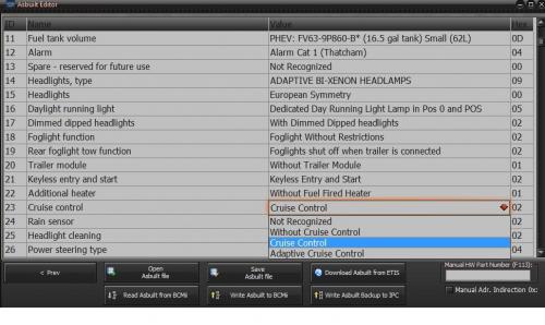

Then it is necessary to change AsBuilt file, mine was line 23 CC to WITH CRUISE CONTROL. Save AsBuilt.
Write AsBuilt into BCMii. In my case it was also necessary to write Asbuilt Backup to IPC.

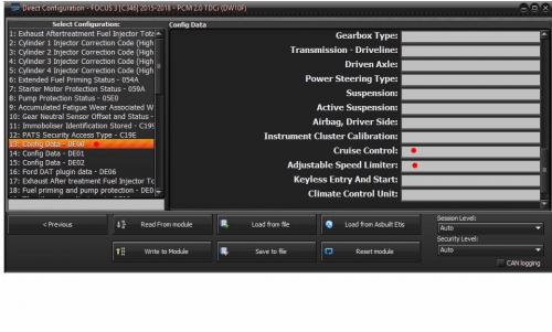

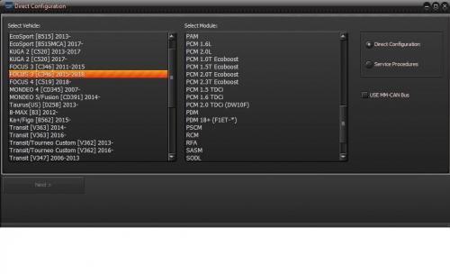

On 4/4/2019 at 12:54 PM, amitshmil said:
Lastly I had to update PCM - DirectConfig, Focus 1.5Tdci, 19:config data - 00, cruise control
I have ucds,  but I don't know which screen to go to etc

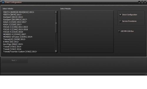

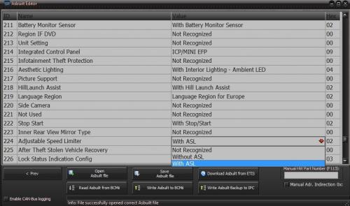

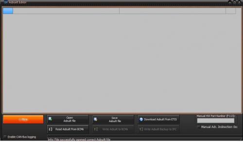

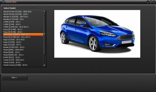

On 12/19/2018 at 7:56 PM, Tezza said:
Enable cruise control to a focus diesel using UCDS
First go into asbuilt editor
Choose the correct vehicle (focus 3 2015) then click next
Click read from BCMi
Changed asbuilt lines  23 to with cruise control
line 224 to with ASL
Now click write asbuilt to BCMi   dash will do its thing  when its finished click write asbuilt backup to IPC  dash will do it thing again (dont worry about faults that show)
Then go into direct configuration
Choose correct vehicle (focus 3 2015-2018)
Find your PCM type
Click on 13 config data DE00
Select line 38 select and change to "Cruise control "
Select Line 39 select ASL
Then click Write to module
Now you will have Cruise control
Andrew8576 follow this guide
