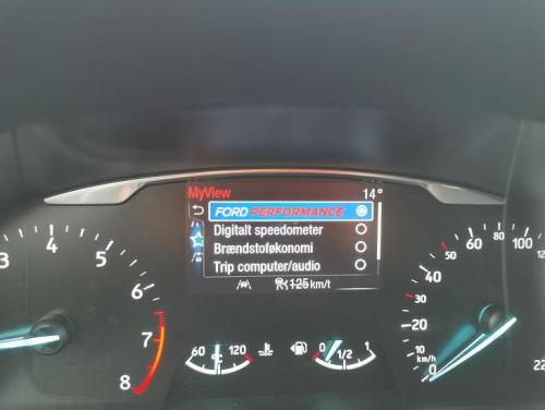

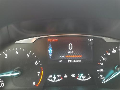

I managed to also active a Ford Performance option in my small dashboard screen, but that didn't really do anything, other than enabling a red themed digital speedometer option.

Are you able to show a picture of the ford performance screen please? @Da9L
I will do that later today :)
Thanks @Da9L! The setup looks cool. Do you always have yours on? Any issues or functionality which doesn't work?

No i actually dont use it like that. Mine is always on the trip computer, with mileage and distance before empty etc. 🙂
