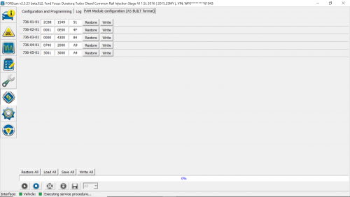

Hi, I have followed your post and installed the electrics and towbar and they all work fine
The problem I have is the rear sensors are staying on. When I go into Forscan I get this rather than the page in your photo.
Any idea where I am going wrong ?
@Musketter I can’t remember, but is there more than one option for the PAM module? Yours says (as built configuration) whereas mine doesn’t in the picture. I think that might be your problem. Have another look, unfortunately the laptop I was using with FORScan at work has recently gone POP, so I don’t have access to it at the moment.
