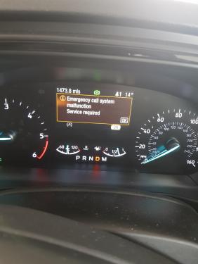

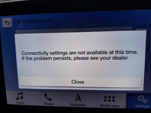

I've just got mine back from Evan's Halshaw today, they have done a software update which has sorted the issue. No longer goes quiet after 23.
Now Fordpass isn't connecting to the vehicle and the message "emergency call systems malfunction service required"
Also says connectivity settings not available at this time on the Sync3
Any ideas anybody?
Emergency call system malfunction most likely a faulty button .

I have had that happen a couple of times since new and discovered by accident that after leaving overnight the problem disappears.
I assume the system must have done a reset or reboot overnight.
