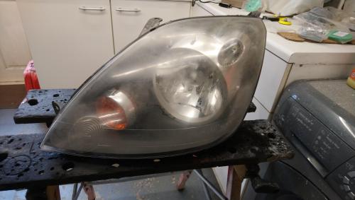

Done the headlights and couldnt be happier with them. Made a huge difference, i’ll attach some pictures of during and after for anyone whos interested.
You did a really good job on them 👍. See sanding isn't as scary as it sounds 😊
Do show us a close up picture of the top where the hazing was. Good thing it was outside not inside the headlights
Super job, well done :)
I was happy with the results I got but I did feel like I could’ve done a better job.
Gone over the lights again with the 2000 grit and then the 3000 grit paper and put the autoglym compound on the top.
The results are twice as good, 100% clear now.
