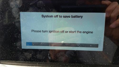

at the same time it shuts down various features including it seems keyless entry on all except drivers door

I understand that the batteries fitted are already heavy duty types because of the auto stop start function so I would have hoped they would be able to cope with the extra demand/drain.
I suppose ideally I would like them to replace the battery to prove the point but I will have to see if they would be prepared to do that.
BTW, I have a voltage monitor plugged into the 12v socket and have noticed that when driving (charging) the voltage can vary say 13.9 – 14.7 V but when stationary (engine off) and left overnight the voltage can be 11.8 – 12.1 V which is probably borderline.

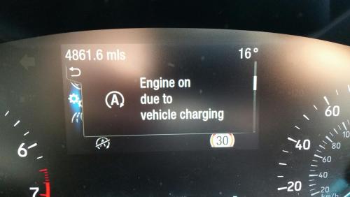

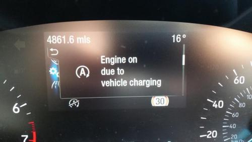

Took my car in yesterday as planned and they informed me that they have charged the battery and that all 4 key-less door locks now work and that the auto stop start should also now start working.
After collecting my car this morning I was pleased to find that all 4 key-less door locks are working correctly. :biggrin:
However, unfortunately my auto stop start still does not work. :sad:
I checked the information display and it shows the following message.
So although my battery has been recently charged my auto stop start is still not working. I found it strange that the information message appears to indicate that the reason is due to the battery still low and requires charging.
I contact my dealer to explain the situation and I am taking it in next week for them to carry out further tests.

Cars booked in Thursday for them to carry out more checks.
I am now back to square one with no 'Auto Stop Start' and only the drivers door 'Key-less' lock/unlock working.
I will also be taking the following screen shots in to show them.
