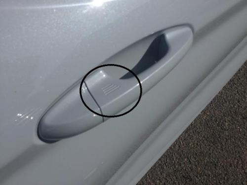

Those that have keyless entry/start on the mk8 how do you lock your car, does the door have a button you can double press and pull handle quickly to check it’s locked, it’s like this on my 2010 focus or do you use the key fob?
Only got keyless start on mine so it's a fob job.😀
7 hours ago, mitch84 said:
I think I will change the setting to off so they stay unfolded in the winter months, I work late a lot so can be frosty when I finish work.
Yeah the keyless entry has three raised lines on the front door handles, double press deadlocks the car and the indicators flash.  To unlock you just put your hand into the door handle and pull.
Or you can just use the fob as normal.
Cool thank's , is it a button on the handle or a sensor, on my 2010 focus with keyless its a button you press and I always press it twice to double lock it.
So no button, just an embedded sensor (4x lines in fact) that you touch to lock.  The sensor inside the handle registers when you've put your hand in to open the door.
