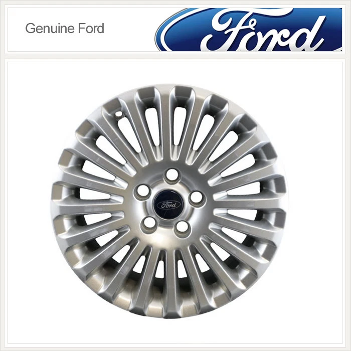

Those wheels are 17" and from a Mk2 C-Max (2010-2015).
If yours are 16" and originally from a 2009 Focus Titanium then they should be these ones.
Genuine Ford C-Max 16 20 - Spoke Alloy Wheel 1440718 - Picture 1 of 1
Yes they are the correct ones. Will these nuts be ok? Solid one pieces nuts?
